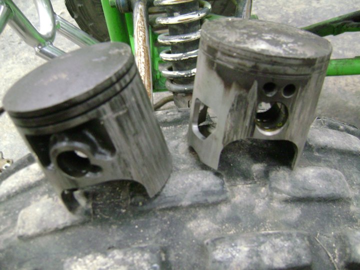

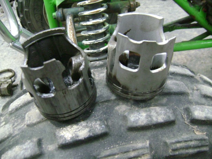

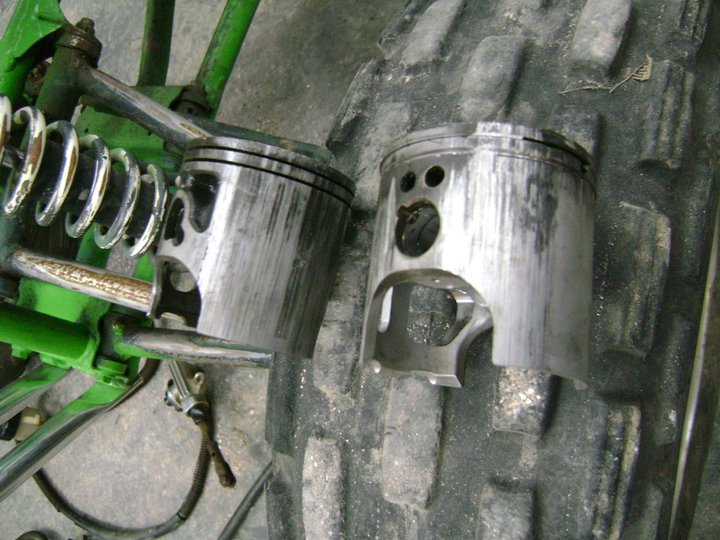

Here's some pictures of failed pistons. Bothe forged and cast. I bet I could contribute the carnage to either ....
#1 improper jetting (too lean)
#2 Incorrect piston clearance
#3 DETONATION (too lean,too much spark advance,or both)
#4 wrong fuel to oil ratio (premix)
#5 Over heating combined with too lean of jetting
#6 High compression with poor quality fuel (DETONATION)
#7 or...a "combo plate" of more than one of the above.
FORGED PISTON...
CAST PISTON
FORGED PISTON
CAST PISTON
FORGED PISTON

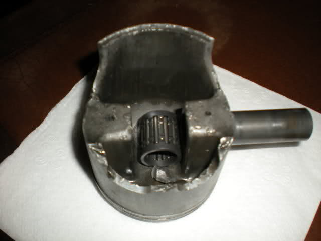

The darn Wiseco needs a careful warm up or you will scuff it. Here are my piston picts:
Cast on the left, broken skirt (too much clearance) Wiseco on right (4 corner seize, too hot too fast)
Notice the rings are stuck in the Wiseco. This is typical. It gets hot and smears.
The aluminum gets smeared all over the bore surface too.
The cast has high silicon which helps to minimize the smearing (and heat expansion).
Good shot of a typical forged piston 4 corner seize on the right.
