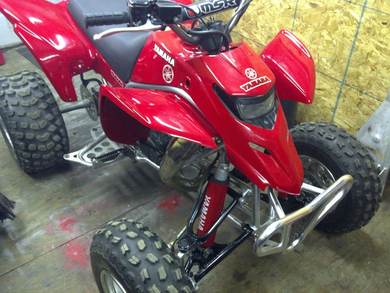

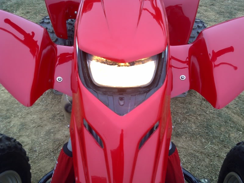

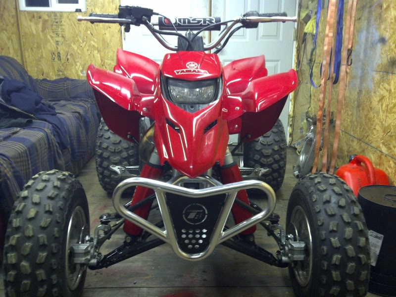

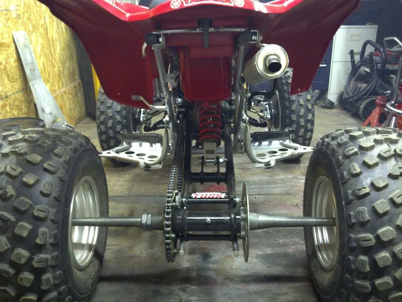

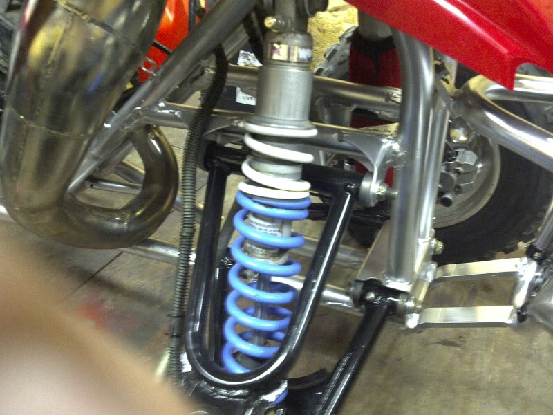

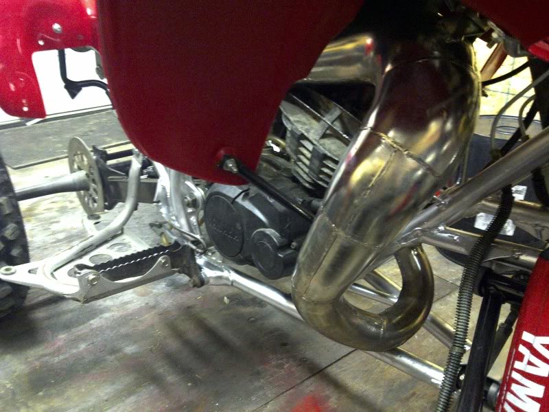

ok guys here it is all done, well except for the motor.
it is a 94 converted to a 03-06 hood, has red maier yfz style plastics, and a CEET gripper seat cover, tusk front bumper and nerfs, and a baja skid plate. stock a arms with 1.25 spacer, and rims flipped. i am using works shocks in the front and a 400ex shock in the rear. rear swing arm is a swingarm shop +4 with stock carrier. i am using a banshee rear axle and yfz450 hubs. i am also running norms front spindles with banshee hubs and rotors, and raptor calipers. has yfz450 wheels and 20x11x9 kenda klaws in the rear, and off brand on the front. motor is pretty much stock, besides a +4 timing mod, and the f7/power pros pipe and silencer.
anyway time for pics...... enjoy, and let me know what you think, thanks dan
