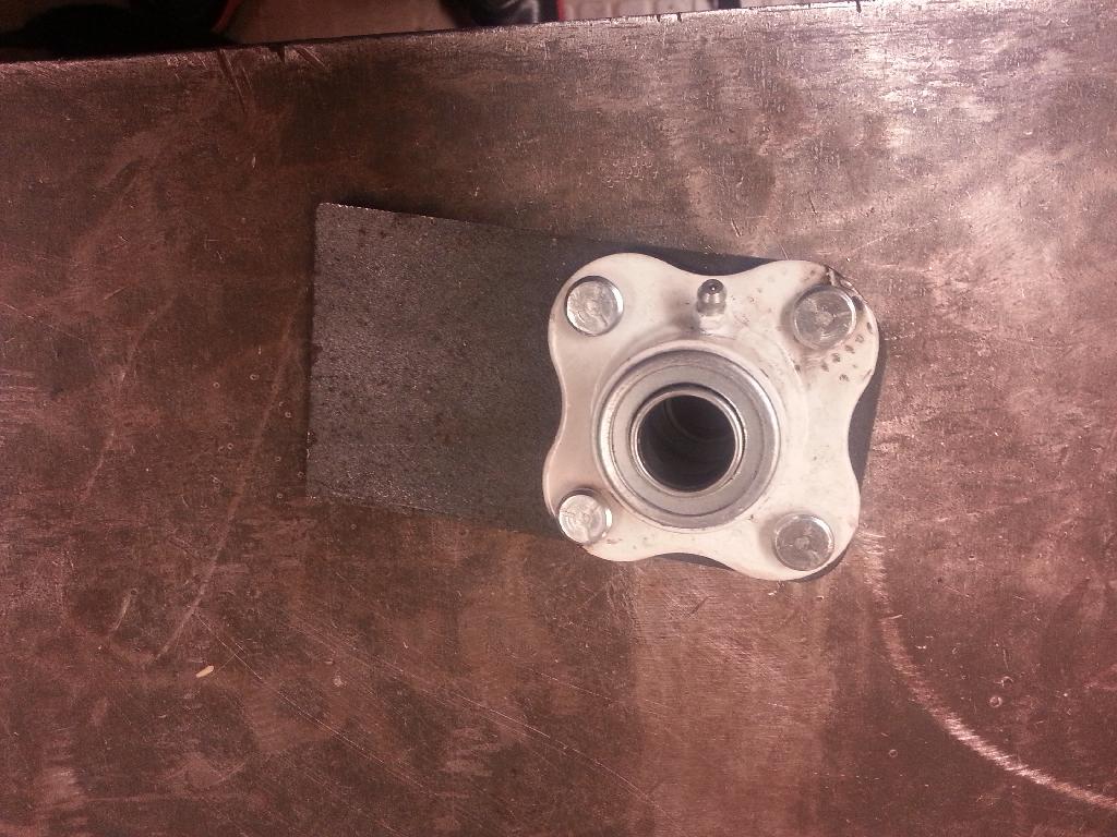

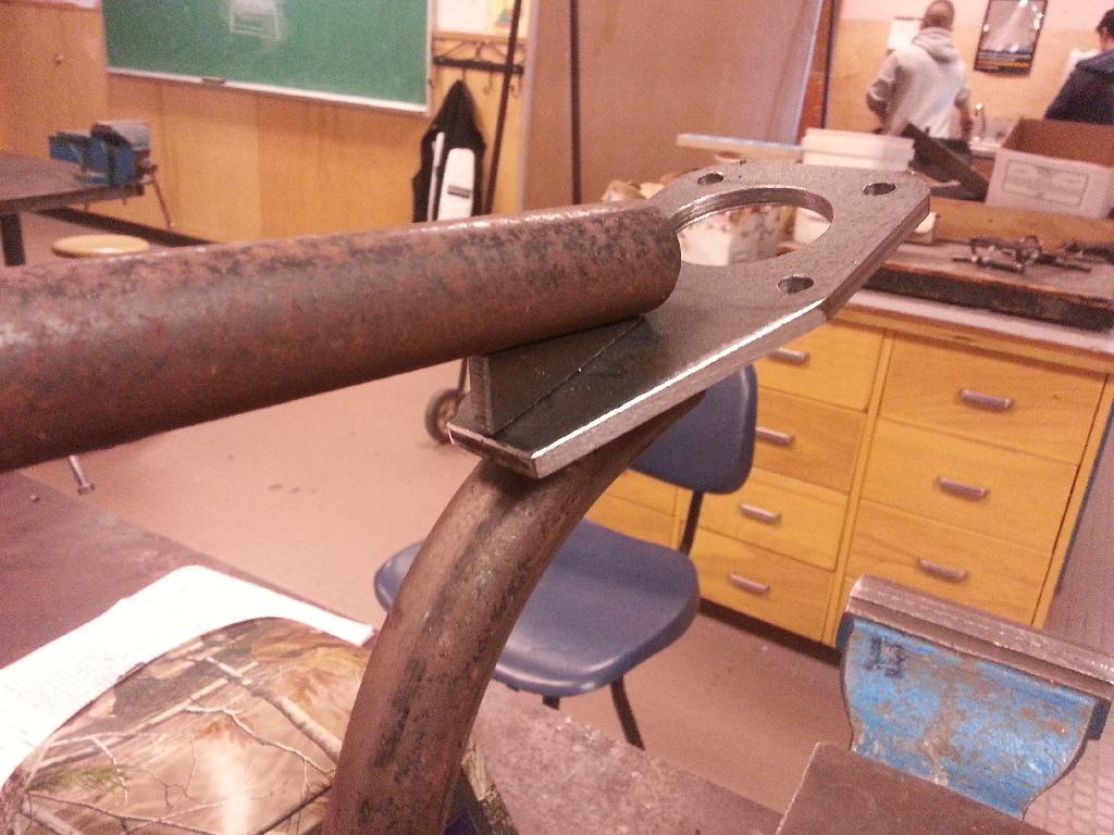

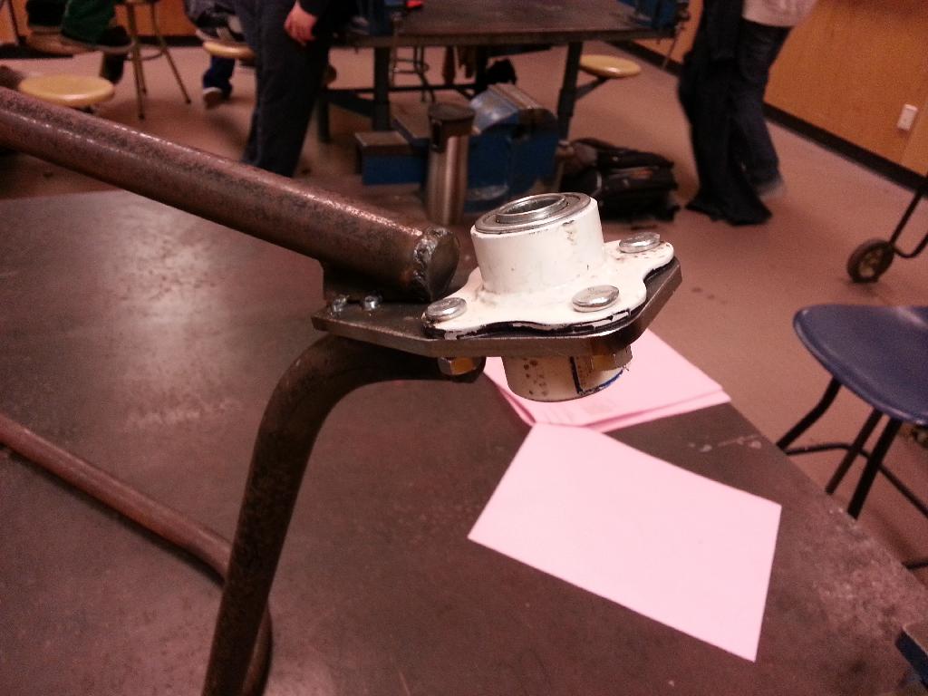

I've got the head tube in place and it's ready to be tacked on. More progress will be made on Monday. Thanks for the support guys, you're the ones that motivate me to post this.

Thanks for the support guys, the engine I will be using is a Honda gx160 and the brakes I will be using are hydraulics from a kx65. I'm going to be adding gussets for more support. The plate I used for the head tube mount is quarter inch.
