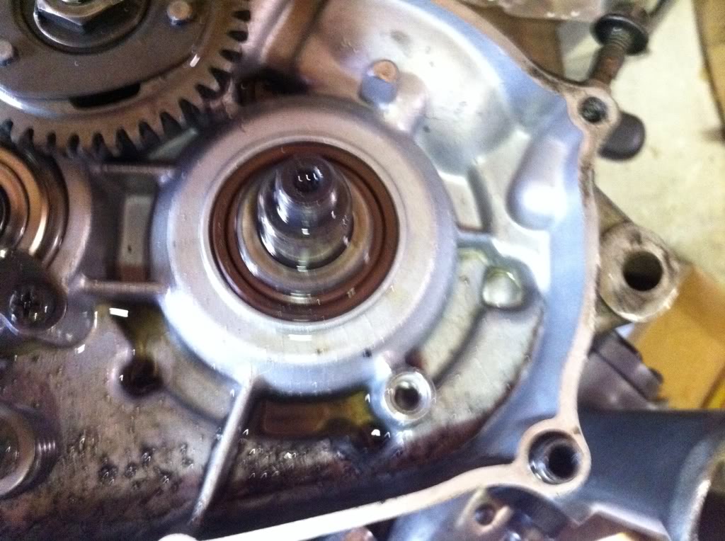

Only if that is where it's leaking. Did you try the pressure test I suggested? It could be the seal between case halves or it could be a cracked or broken case.
	That's actually how the seal looks. Unless you mean there is a seal under it or something
It is a double lipped, suck and blow seal, to stop pressure getting out of crancase and oil getting in.
like i said that was after i replaced it
I got confused the pic showed a good seal.
So someone put in two seals, one backward and one forward , right.
bingo,
