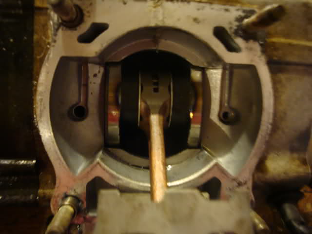

tore into my engine today, there is some blueing on the crank as well as about a mm of side to side play, not the up and down like i was anticipaiting.
let me know what u think about it
its still getting tore apart for the air leak regardless, just sharing pics for the pic hounds
Doesn't look too bad, check it with a feeler gauge & see what ya got... I'm not positive but I think around .035 is ok, have check to make sure though.
are those needle bearings on the bottom of the rod crooked. they kinda look it. if they aren't perfectly straight it's screwed.
well the .55mm feeler gauge fist in there lol, so i guess it is cooked like i though to was, i knew it was messed so i am not dissapointed nor surprised, i have a much better engine that should be here anyday now.
plus the bottom end is called for anyways, just thought i would show u guys
