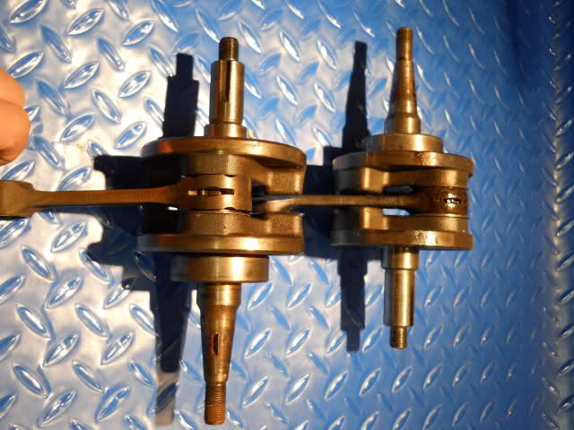

i took the top end off 2day. and the piston wont go up or down still. so im guessing its a rod bearing. and i had to take a ring off the piston to put the cylinder bak on cuz the bottom ring wouldnt let it. is the ring bad?

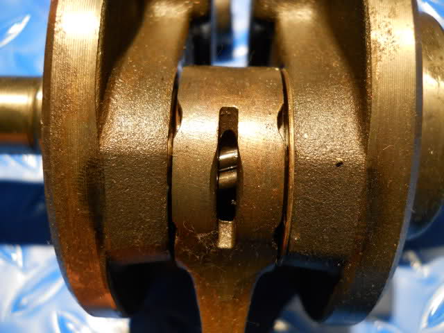

so was the tranny in neutral when you tried to move the piston? if not it won't move. look at the bottom of the rod where it attaches to the crank. you should be able to see the bearings in the slots cut out of the rod are they straight in there or crooked. what do the washers on either side of the rod look like? let me get a pic of a bad one for ya real quick
ok here ya go. the first one you can see the crooked needle bearings in the big end rod bearing and the left thrust washer is getting a little thin
In this one you can see the crooked bearings and the left thrust washer is completely gone.
