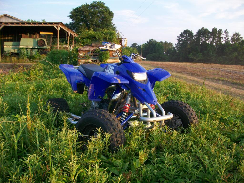

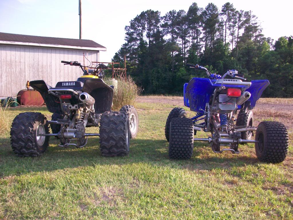

Re: My '03 Project

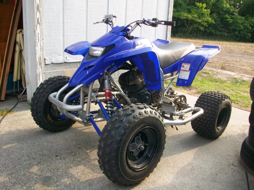

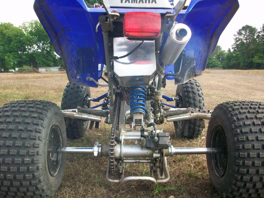

pics of 250r rear and stance. begging for that +4 swinger now.
Re: My '03 Project
if your blaster had my colors i would be in heavan if i do a build it will be really close to this i love it
how much taller is that shock?
Re: My '03 Project
not sure how much longer the shock is man. 16.25 or something i thought i read.

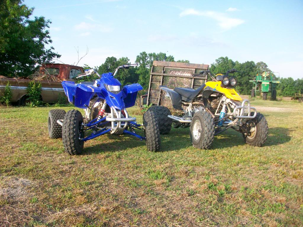

pics from yesterday. messed around with the warrior a bit and threw my mud sharks on it. gonna play in the mud today if my crew rides.

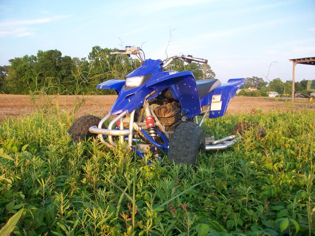

some random pics of the blaster

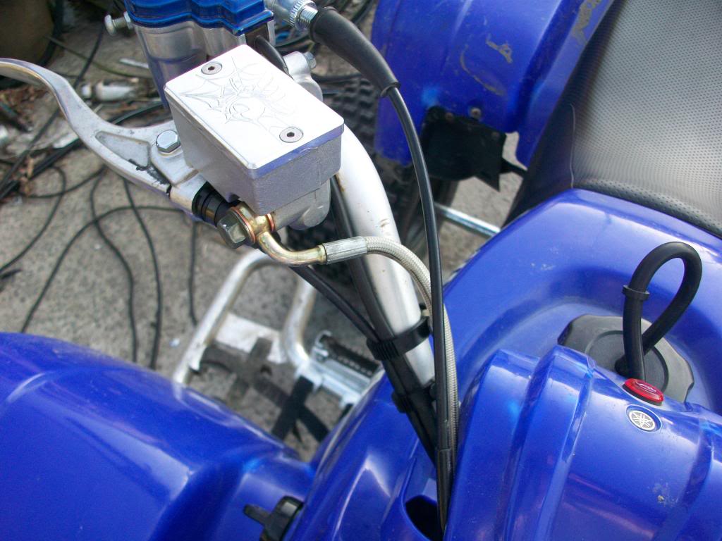

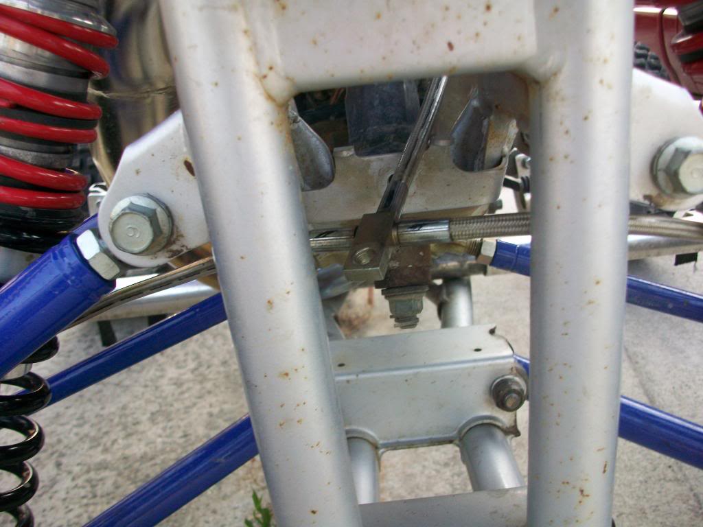

update: installed some polaris predator 500 stainless brake lines on the front. here's a few pics for a couple guys that wanted to see them. got the idea from stabor a while back when he did it. i can confirm that these stock polaris lines will work with your +3 arms.
only thing i see that i don't like is the t-block doesn't bolt to the 03+ bracket. also, if you can look past the 90* bend at the brake rezzy they'll work fine.

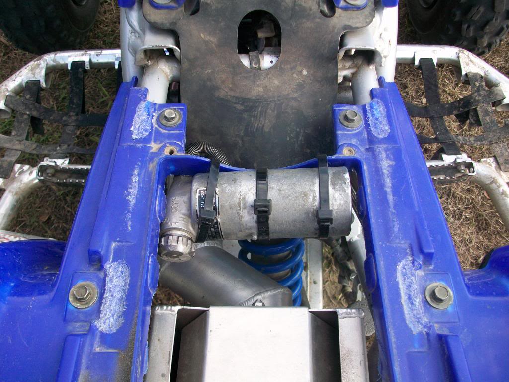

Re: My '03 Project
good idea with the lines.........good work man, but I have to say did they weld your CFM wrong or did you mount it that low on purpose?
Re: My '03 Project
they did weld it wrong. i have it mounted as high as the frame crossbar will allow. been redrilled and everything. it's cool though. i'll probably order another one down the road.
Re: My '03 Project
That sucks man...but builds looking good, once you get a longer swing that shock will be sweet I have a YFZ rear and have it set high to get a little more clearance but you'll want a swing for sure.......keep up the goos work and picsI:I
Looks good. Good to know that they fit with the +arms. The ones I used were from an 06 Outlaw I believe and the fitting at the rezzy was like a 15* angle. I actually like the way the pne you used turns 90*. Looks like it routes it perfectly to me. I would fab an L bracket off of the old mount to secure the "T". Great job on the build. I:I

hmm, didn't think about making a bracket for the "T". i'll see what i can come up with. thanks for the comments.
