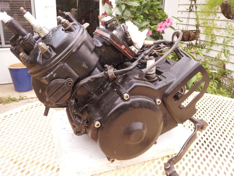

I have a complete DT200r motor.
All electrical (stator, servos for PV, etc.), cooling, carb, and rightbend pipe (dent in lower tube, no flange).
Just noticed shift shaft is tweaked, I'm waiting for the new one to come in from Yamaha.
Only sell it as a whole, located in Eastern Pa.
