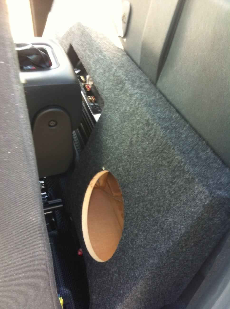

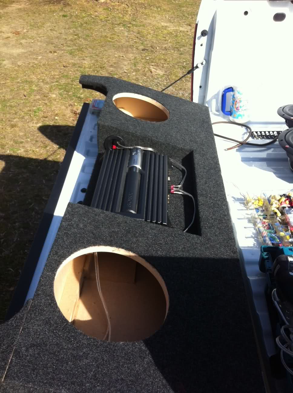

Well my box came in today, and it is a fantastic piece of equipment. The only downside is I can’t fir both amps in the provided slot so I’m going to have to change my plans a bit.
Here is how it looks with the amp installed.
I then test fit it into the truck before I installed the subs. You can’t install the subs with the box in the truck, there is simply no room back there.

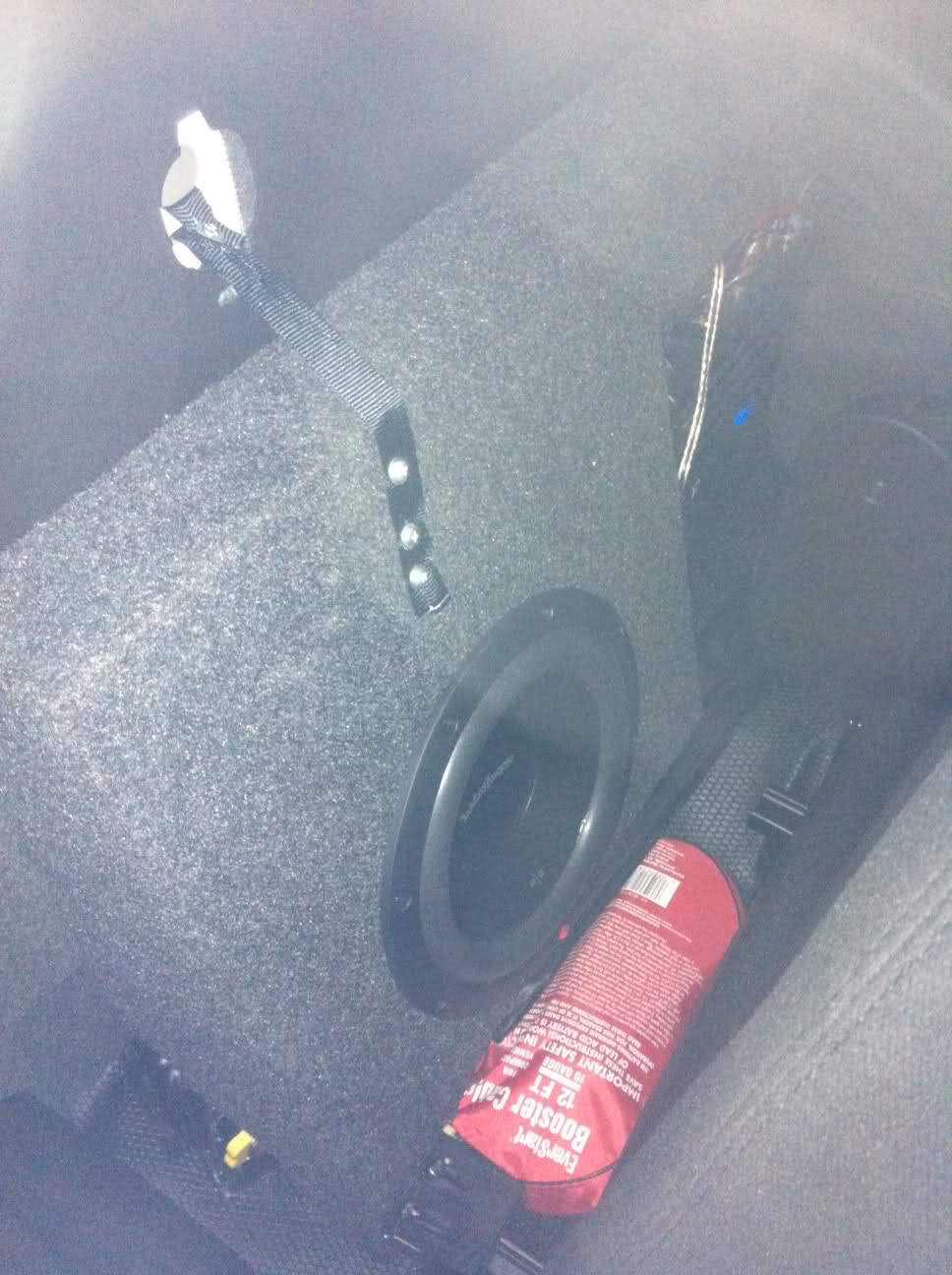

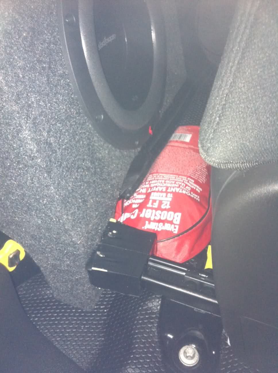

After the test fit I installed the subs and placed it in the truck. I already had all the wiring ran so I hooked it up to make sure everything was working correctly before I made it tidy. I soon found out that my PAC unit wasn’t supplying power to the blue remote wire, so I ripped the stereo out and made sure it was all connected and plugged in securely. It was! Next I broke out the multi meter to trace the problem. It seems the radio wasn’t supplying power to the PAC unit, so I’m not sure what the problem is there. Since I had the multi meter out I decided to search for another switched 12 volt wire back there. Guess what, there isn’t one. Not one freaking 12 volt switched wire on this stinking radio!
I eventually worked something out and found a suitable wire to power the remote, but I’m not going into it here. Once I had that problem sorted the amp and subs came to life. I was able to adjust the PAC outputs to where I wanted them so I buttoned the radio back up and started adjusting the amp. Sorry I didn’t take anymore pics, I was too frustrated, but I’ll get some more tomorrow when I tidy the whole thing up.
All in all it sound great, but I really don’t like where I have to position my seat to provide enough room for the subs. I’ll play with it a little more tomorrow and see if I can squeeze another notch or two out of the seat.
