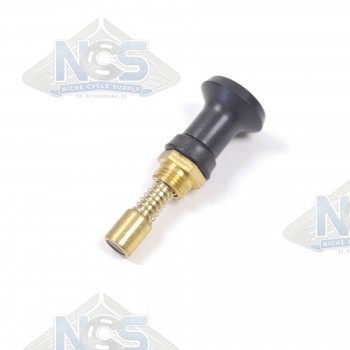

Hose at bottom is bowl drain and overflow. Best you might do is spray the shaft.with brake or carb clean and work it back and forth. Be aware thatst stupid expensive
Cleaner didnt work for me. However i did find that plunger in the link shown above. Will that work? Why doesnt it have the needle?
