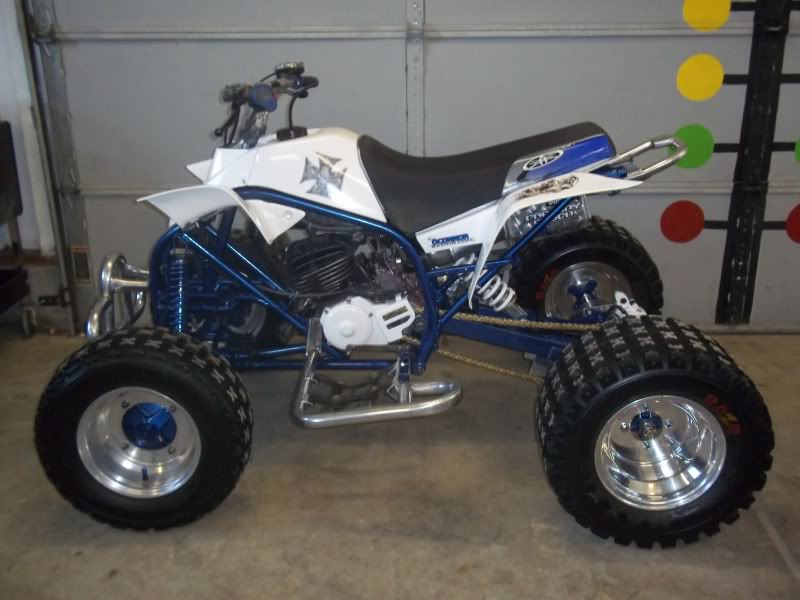

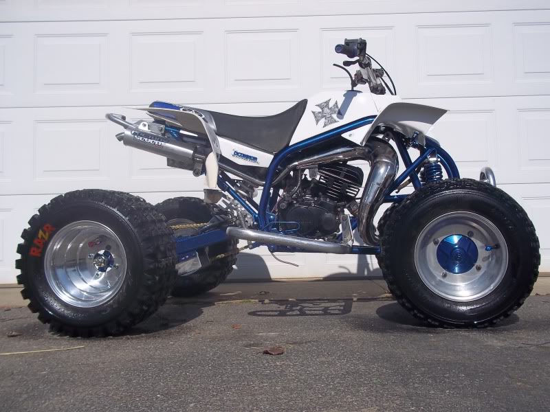

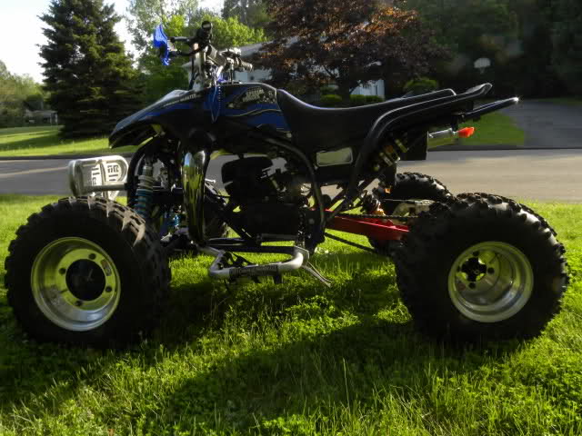

A Arms: stock
Swingarm: T Rock + 4
Steering Stem: stock
Stabilizer: none
Axle : G Force adjustable
Carrier: stock
Locknut: G Force
Hubs F|R: stock
Bars: renthal
Throttle/Clutch Lever: stock
Grips: AME grips
Nerfs: unknown brand
Bumper: unknown aftermarket
Grab Bar: None
Front Shocks: stock
Rear Shock: 400 ex
Brake Lines: stock front, rear Awk's hyd
Rotors F|R: stock
Rims F|R: douglass alum
Tires F|R: holeshots front, rear 20 x 11 x 10 maxxis razrs
Body: stock
Frame: stock
Plastic: custom cut
Graphics|Seat Cover: ceet cover
Number Backgrounds: none
Handguards: none
Bar Pad: renthal
Fuel Tank: stock
Engine|Drive System: Ken Oconnor
Cylinder|Head: Ken Oconnor modded
Bore & Stroke: stock bore , + 3 stroker crank
Displacement: ?
Cam: n/a
Carburetor: Keihin 35 mm pwk
Air Filter|Box: uni filter, Factory 7 air box
Pipe|Silencer: F 7
Clutch|Plates: new clutch, lightned flywheel
Gearing F|R: 13/40 & 14/40 depending on where I ride
CDI|Killswitch: stock
Cooling: stock
Other:
__________________

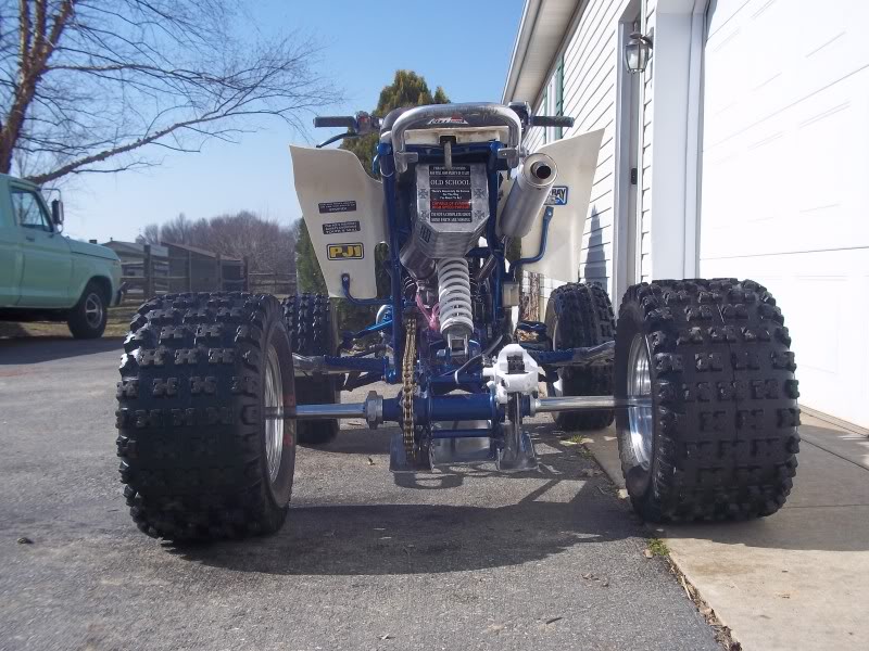

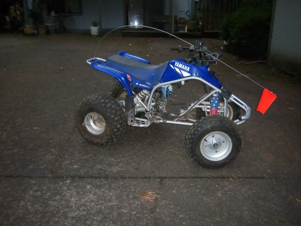

A Arms: Stock
Swingarm: Stock
Steering Stem: Stock
Stabilizer: None
Axle : Stock
Carrier: Stock
Locknut: Stock
Hubs F|R: Stock | Stock
Bars: Renthal
Throttle/Clutch Lever: Factory
Grips: Aftermarket Generic
Nerfs: None
Bumper: Factory
Grab Bar: None
Front Shocks: Shockworks
Rear Shock: Shockworks
Brake Lines: Factory
Rotors F|R: Stock | Stock
Rims F|R: Stock | Stock
Tires F|R: ITP Holeshots
Body: Fenders Cut
Frame: Stock
Plastic: Factory minus Fenders
Graphics|Seat Cover: None
Number Backgrounds: None
Handguards: None
Bar Pad: Yes
Fuel Tank: Stock
Engine currently under rebuild

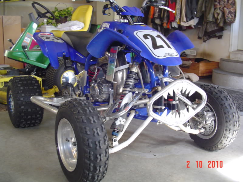

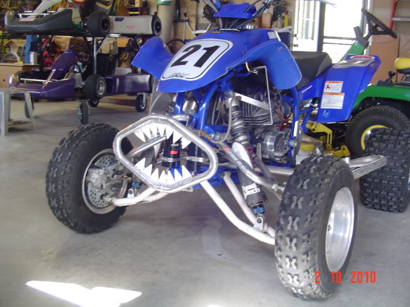

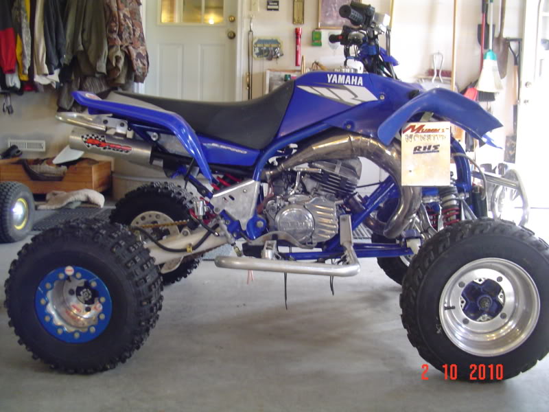

A Arms: +4+1 atv fourplay long travel
Swingarm: +3 atv fourplay round housing
Stabilizer: none
Axle : durablue eliminator
Carrier: fireball racing
Locknut: durablue
Hubs F|R: stock
Bars: stock
Grips: stock
Nerfs: xfr propeg
Bumper: xfr jaws
Grab Bar: dg
Front Shocks: custom axis triple rate long travels w/ adjustable comp & rebound
Rear Shock: custom axis trx250r spring w/ adjustable comp & rebound
Brake Lines: +4 steel braided front / stock rear
Rotors F|R: stock / saw blade
Rims F|R: douglas fronts / omf beadlock rear
Tires F|R: holeshots front, custom grooved turftamer rears
Body: maier race front / stock rear
Frame: stock powder coated blue
Plastic: maier race front / stock rear
Graphics|Seat Cover: stock
Number Backgrounds: k&k atv
Handguards: none
Bar Pad: none
Fuel Tank: stock
Engine|Drive System: mumms the word ported
Cylinder|Head: vito's
Bore & Stroke: 72mm / 60mm
Displacement: 244cc
Cam: n/a
Carburetor: Keihin 35mm airstryker
Air Filter|Box: uni filter, cfm aluminum airbox
Pipe|Silencer: dynoport high volume
Clutch|Plates: ebc clutch
Gearing F|R: 13/38
CDI|Killswitch: tether
Cooling: cfm air scoops
Other: t.m. designworks stator cover, aluminum gas cap, aluminum rear brake rezzy, v-force 3 reeds

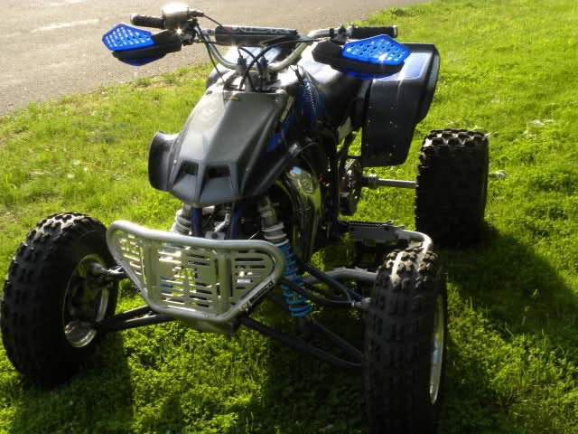

Red Lable .190 Douglas rims
wraped in ITP Holeshot mxr6's
chassis skidplate
Maier Plastics
Maier (Custom made) Carbon hood/front fender
Msr bars w/ ODI grips
blue powermaid handguards
Pro DesignKillswitch
Streamline Steering damper (7-way adjust)
DG bumper & nerfs
Project blaster graphics and seat cover
galifer wave rotor
oil block off kit
14/39 gearing

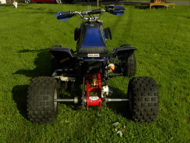

suspension:
Burguard +4 (+1 forward) A-arms
Works front suspension
Lonestar rear axle
Lonstar +2 rear swingarm
Elka ELITE rear shock (high/low speed compression, rebound and preload adjust)
Engine / Intake:
EBC race clutch
Custom porting and polishing
.20 over weisco piston
hot rods camshaft
V Force 3 reeds w/ reed spacer
Toomey B1 exhaust / filter
stock air intake w/ custom air box lid
32:1 c10 mix
