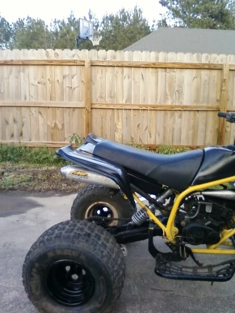

Make blaster bigger
I'm thinking they look a wholeeeee lot better with an extended swingarm, extended a-arms, and axle.
Bigger tires may make it look smaller, i like the 18's on rear, 19's or 20's on front look for a blaster.
All of the above, and you can make it feel bigger by keeping the fuel and oil tank full to the brim.
Maybe I misread the question, did you mean bigger, or better and/or faster?
mostly just making it wider and longer its already pretty snappy. what about tie rod extensions and swing arm extensions does anybody have any input on them the ups and downs
Its not hard at all to extend your own swing arm,if you have a welder handy..
Im using honda 300ex rear hubs and honda offset rims,made the back about 4" wider without spacers..
I also moved my plastics back 4" or so,thats probably the best mod for "feeling"bigger..
Banshee axle with spacer blocks or studs will widen the back.
Aftermarket A arms, and tie rods will widen the front.
If money is tight you can widen the front with a Diamond widening kit.
Extended swing arm to make it longer.
Rumors have it that swing arm extensions can give problems, but I cannot comment as I have not yet tried one.
Getting it lower should also be considered if you are looking at speedy stuff!
I had a + 4 swinger , 5 inches of wheel spacers out back and +3+1 a arms up front and a plus 2 steering stem on the blaster and compared to my buddy's 400ex my blaster was wider and longer but sat just a tad lower and in the wide open he had me but in the trails I would leave him in the dust
