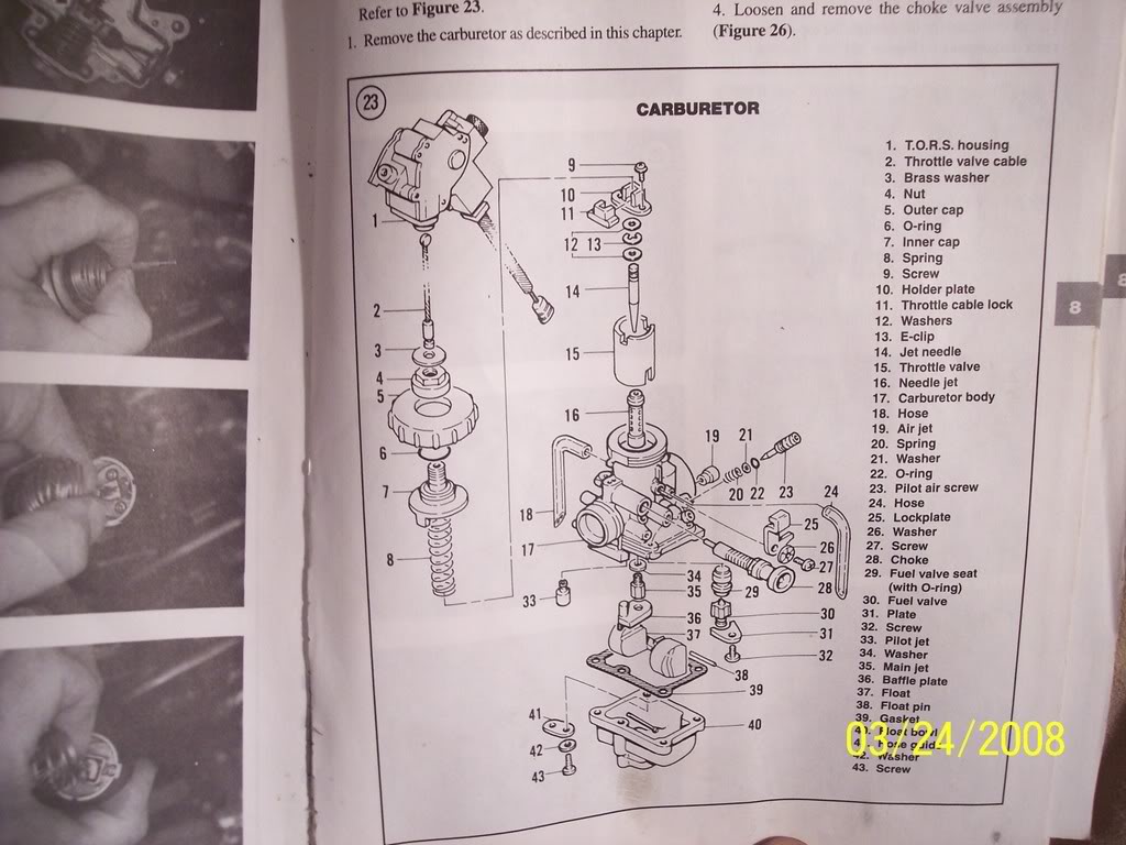

yea tat could be the cause here is sum diagram of the carb to help ya think i got it off de forum ??
hope it helps!!!
