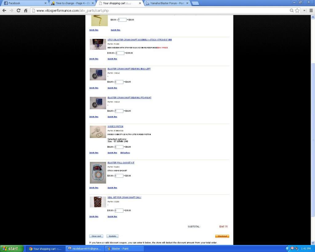

Ok I'm gonna rebuild the lower end with help from a friend and I wanna order all the parts at one time so I can have this thing all finished in one day.
Here is a list.

Well I looked up the oem gaskets and they are cheaper so I think I will order all oem parts except the vito's crank and piston.

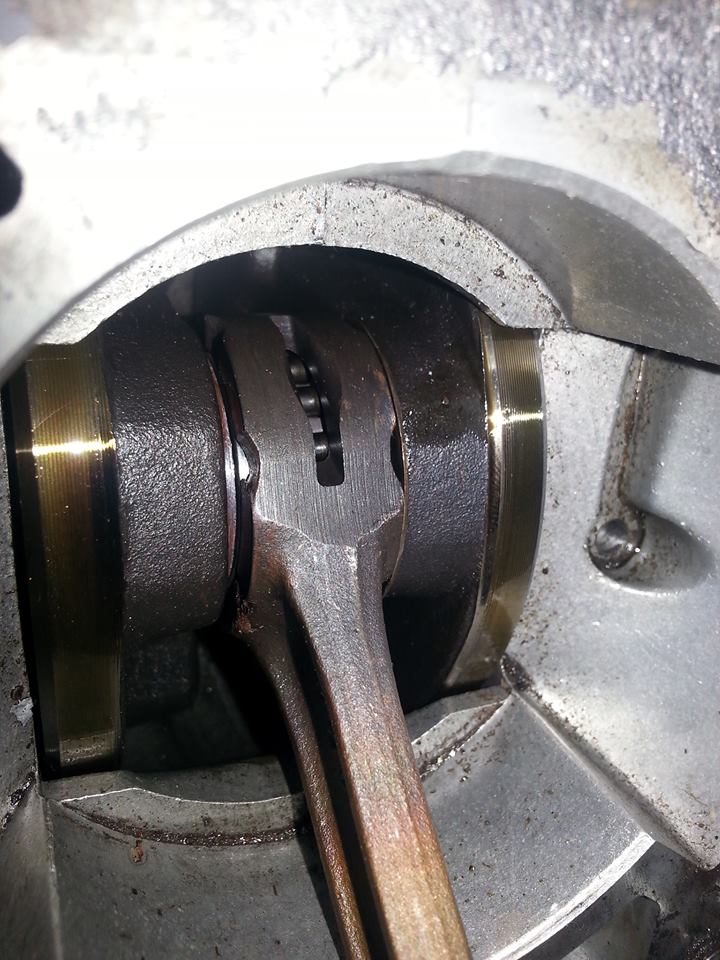

So you can see its missing one of the washers.
I'm gonna order the stroker crank but what I need to know is the space that vito's include do I use a oem base gasket with that or just the spacer. ?
