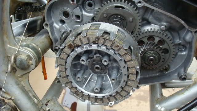

ok dude, heres a pic of my clucth i tore apart last year, explain to me what broke off

basically the clutch frictions area pressed against the steels by the pressure plate, which gets its pressure from those 5 little springs. the clutch releases when the small rods inside there push out on the pressure plate. thats the 2 second run down of how it works :)
