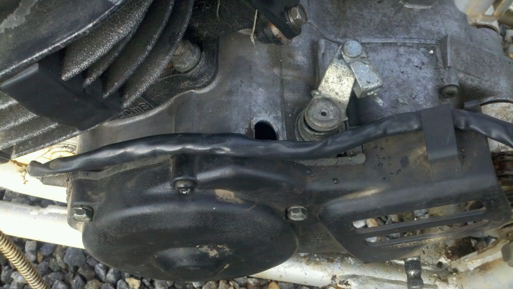

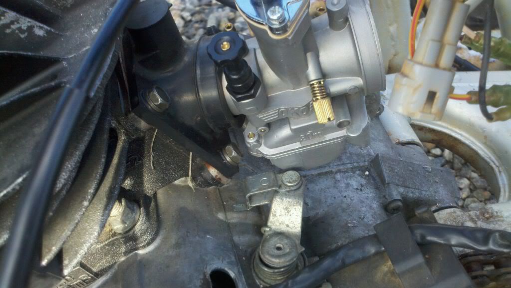

On this first 3 pictures, is the cluth right? im having clearence issues with my carb, adn thought it may need to be on the oppisite side. I tryed to see if it would rotate, but it woudl not so im figureing i'll need a spacer for my carb, or something.

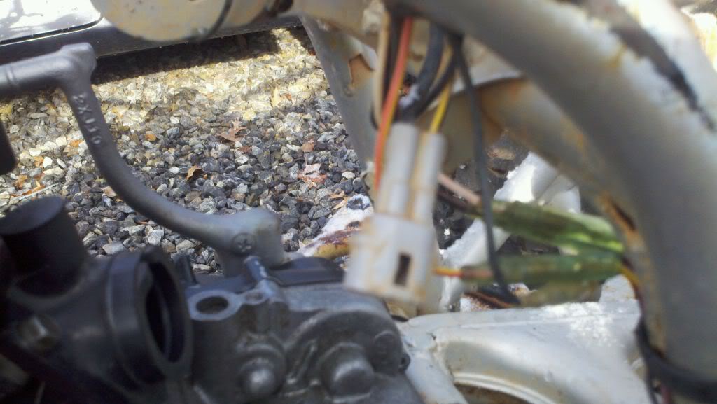

On this second picture what does the gray connector go to? I think its the oil injection but want to make sure before i skip putin that part on.

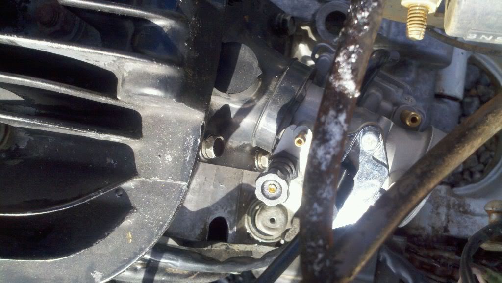

Ok, on this picture, what is the hole for next to the clutch?

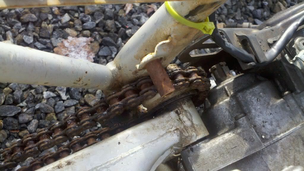

ok, and on this pigure what gos on the part of the fram above the chain?
Looks like you will need a spacer to help with the carb issue since it's not the stock one.
I'm pretty sure the grey connector is for the TORS, which you won't need.
The thing above the chain is where a chain roller goes. You need a new chain too
the hole in front of the clutch arm is just supposed to have a rubber plug in it. nothing major, but dont leave it open
where can i get that at? i was looking on bike bandit but cant find it on there.
edit**... i found one on the old motor. its in a million pieces and most are missing so i suppose i got lucky.
yea, the chain is in the plan, i was going to get it put back toghater and running. then afterwards get a new chain.
does the V3 give any extra clearence? i was thinking if any of the aftermarket reed assembleies woudl do it i'd prefer to invest the 20 dollars towards them instead of towards a spacer.
