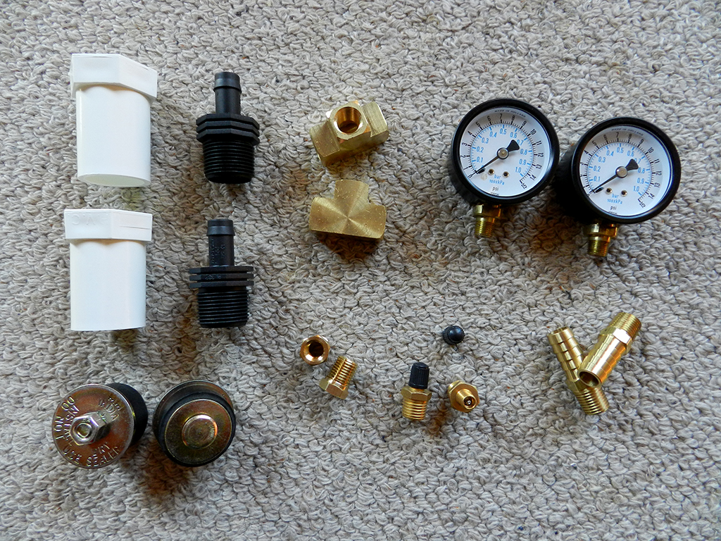

You are right, he mentions that in the very beginning. I was thinking the whole test was a heck of a lot longer. Removing the carb and the expansion chamber doesn't add that much more time. Still its a test thats not too complicated. I was looking at AWKs leak down tester doesn't seem to hard to construct. Im gonna have to do some research and make a parts list.

Buy one.
http://www.blasterforum.com/threads/leakdown-testers.55015/
Parts I used to make 2.
