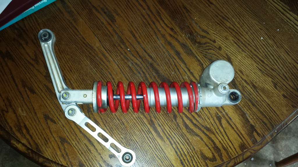

On a positive note, this little gem came in the mail today. I had an epic Ebay bidding war that I won at $32.99
Now I just got to get this thing running again, and get the bushings kit from KOR.
