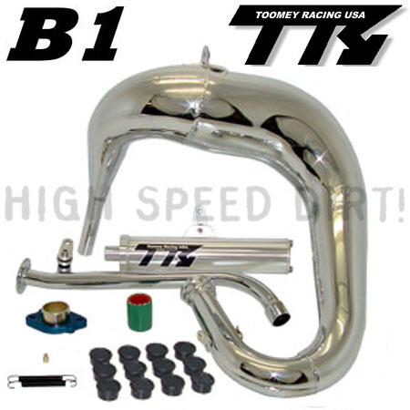

Ok just saw toomey is a right bend, but a lot of people say it's not the bend that makes the difference.
Toomey is not a right bend. As you can see in the picture, the bend off the cylinder goes to the right (would be left when installed.)
it goes up and around, rather than turned in out.
Im no expert, but my guess as to the difference in left/right bends is how the exhaust move.
Right bend pipes are better for the upper rpm range power, where as left (toomey) runs a little lower rpms
toomey's are left bends, same as stock.
the toomey kit includes one jet, i think a 310, a uni filter and airbox lid vents, IIRC.
