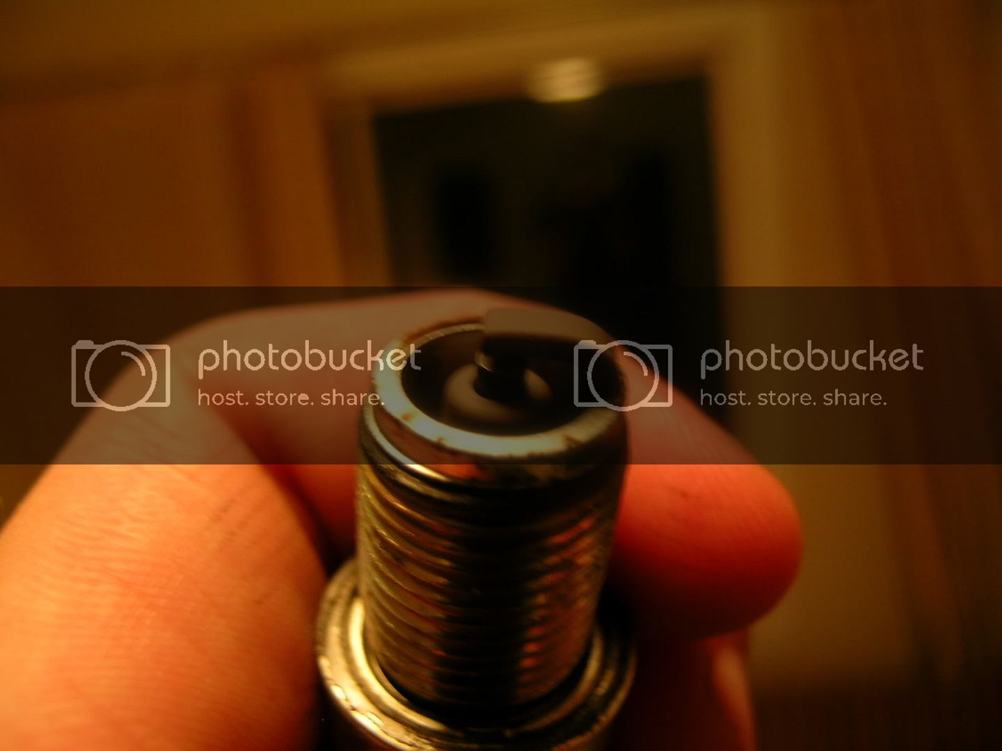

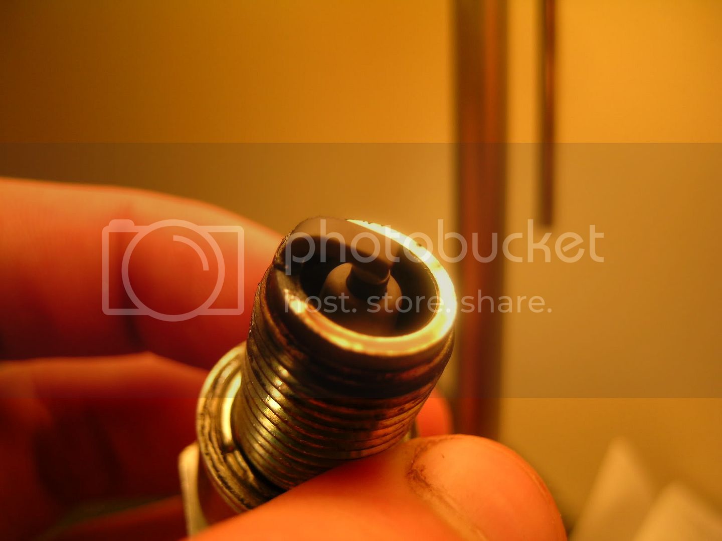

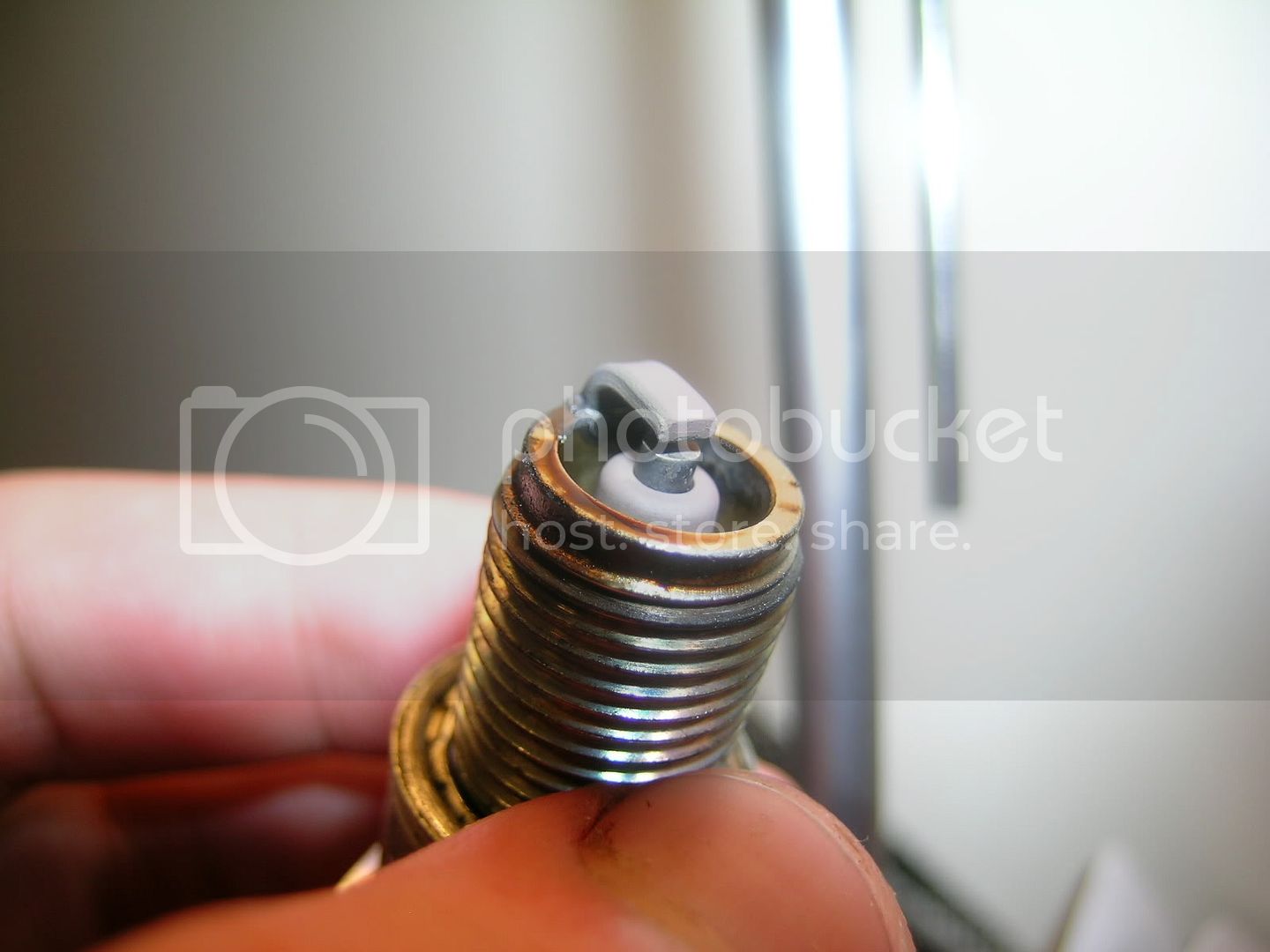

So after pulling my plug today after a good 3-4 hours of riding i see that the color is Primer gray very similar to this, my main jet is a #220 and im looking for opinions on how much up i should go in the main and pilot?
Here are some pictures i tried to take
Performance mods include:
Boost bottle
Port and polish
.080 over
Mikuni TM series carb
To be honest i have no idea what size the carb is... came with the quad when i got it, i should measure it one of these days, definitely much bigger then stock though, if i had to guess i would say 30-34mm
well try changing the main jet and start run it and then check the plug if its stii the same color then change the jet up another size and keep trying that till it changes a carmel color but make sure you dont make it to rich
