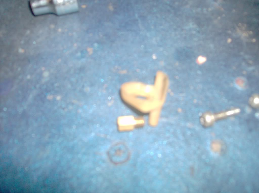

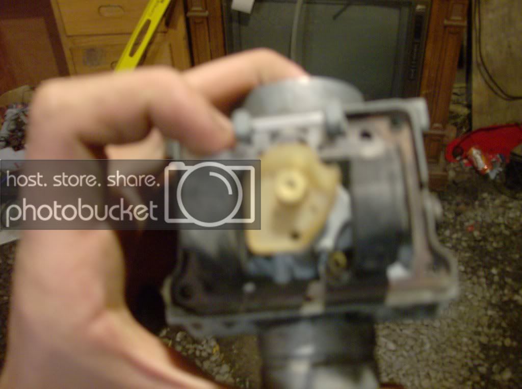

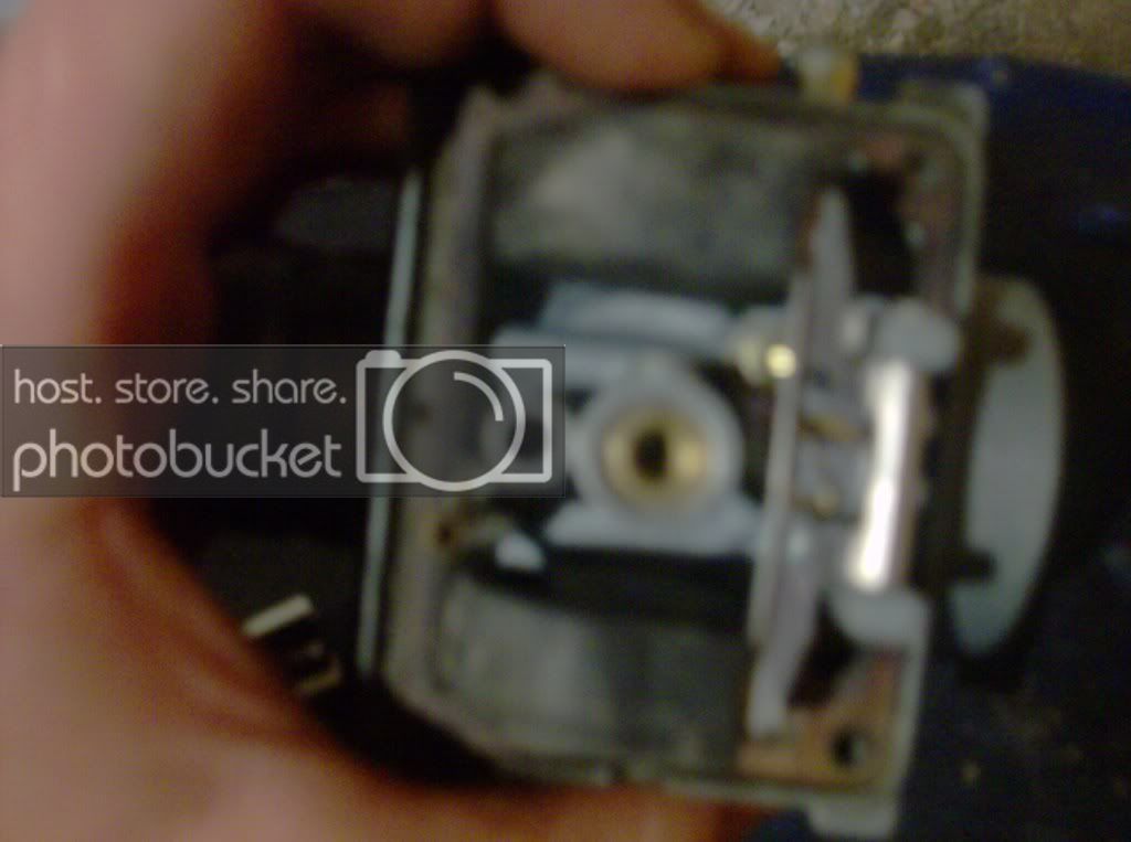

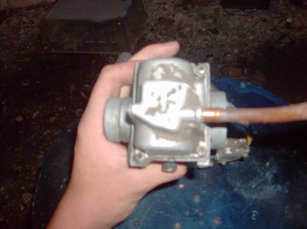

first picture is of the carb together. next one is of the bowl off u can see the main jet in the middle. 3rd is of the main jet out spray that with carb cleaner also for it could be cloged. last is of the main jet and i cant for the life of me remeber what that plastic piece is called lol but good luck hope this helps here ar the pictures

well take the needle out on top of the carb unscew it so u clean the main jet passage geting it back in sucks because u gota line up little slots but u cant hurt anything. piliot jet is right next to the main in that little hole just use a flat head screwdriver to take it out and clean that. things u will need philips screwdriver flat screwdriver 7mm socket and rachet. make sure u have the right size screw driver when taking the bowl off them screws striplike nothing

theres threads on it its lik a srew or bolt u just put it in snug
