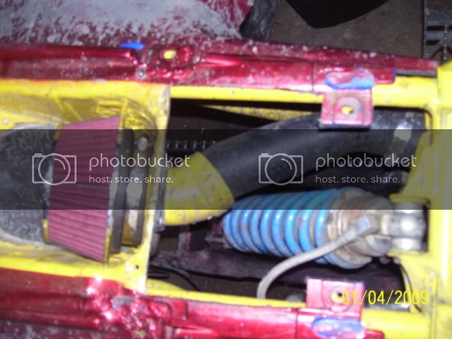

that sounds like it would work to me, and it would eliminate that restrictive narrow bend in the stock setup, kinda like the aluminum airboxes do, now you got my brain cells vibrating, maybe a piece of pre bent radiator hose from a car radiator would work for the bend it needs to clear the shock and back around to the carb??? and i have seen pics of peeps using a rubber reducing clamp thats used for plumbing (fernco coupling)to adapt different sizes together, and being an electrician all my life, i have heated pvc pipe with a torch and bent it in all kinds of shapes, gotta heat it slowly, constantly moving the torch, so ya dont burn it, so thats a possibility too
i'm gonna have to look into that
and you'd have to get an answer from someone running an aftermarket airbox if they had to rejet for the increased flow, i'm guessin yes, but maybe only 1 or 2 sizes up???
