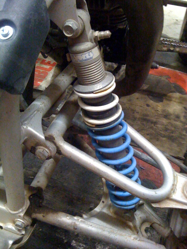

I have these front shocks on my blaster. Ive read that works are good, Im wondering how to adjust them. They have a threaded piece on the top that looks like I could connect an air compressor to.
Any info I could get on these would be great. Ive been reading about replacing the front shocks but if I have good ones already, Ill focus on the rears.
Koo. I just wonder cause Im a bigger guy and dont want my stuff bottoming out.
So far its been ok, Ive jumped it a few times and I havent had any issues with it bottoming out, so the front shocks must be doing their job.
I know my rear is stock tho. I need to find a sweet deal on a 400/450 rear shock.
those are works dual rate shock, and there is a clip under the top cap, but ya gotta compress the spring to adjust it, and no there is no external settings, but they are made for a certain weight rider and riding style when ordered, <<< i ordered brand new ones once, but have used ones on this bike, i luv them, great shock for our blasters
and go with the 400ex shock for the rear, 450 is the same (i have one on now) but has an offset rezzie, which causes frame interference,
the 400 is easier to mount, get ahold of oconnor on here, ken has bushings for sale that make it a 1/2 hour job
