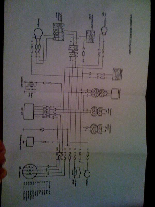

im not sure how to read the wiring from the PDF..so Please just break it down for me...
I only want whats needed to make it run...no lights, oil pump, tors, light switch, ...ect...thanxs for all the help...and I did search the forum and only found one post with some of the info...and I have a 2k Blaster...thanxs for any help..
I dont want/need lights..I just need to know what needs to be hooked up to make the bike run...thats all!!!
I think your missing what I am asking...
thats what I am working with...

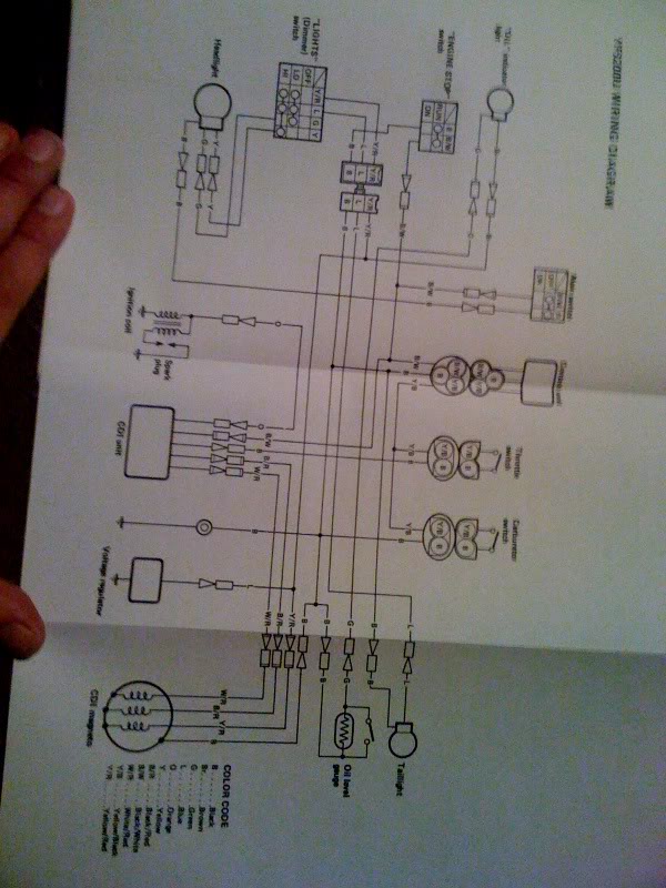

On topic here is a pic of the wireing diagram. For the stuff you dont to run anymore just delete those wires.
HAHA...they are on up side down...Im telling you the guy I got the bike was didnt care after it had got stolen...this is how he got it back from the police....
For the most part, you willneed the wire going to the coil and cdi and then on either to the kill or key to shut it off (grounds it out)
You only need the orange wire from cdi unit to coil and the black/white wire from the cdi unit. The b/w wire need to go to a kill switch,toggle switch,etc.. to be used as a cut off. The black wire from the cdi magneto also is a frame ground! I use a toggle switch with a pull tether kill switch for my blaster. The toggle keeps me from having to pull the tether every time I kill the motor.
