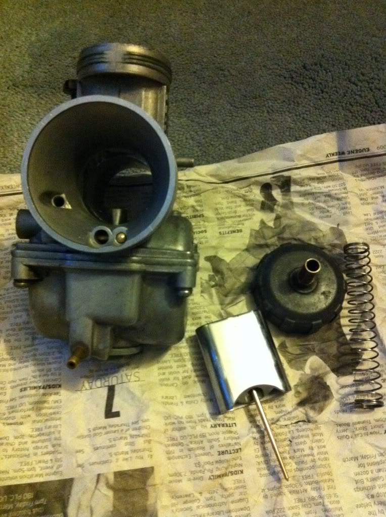

heres it is half taken apart...

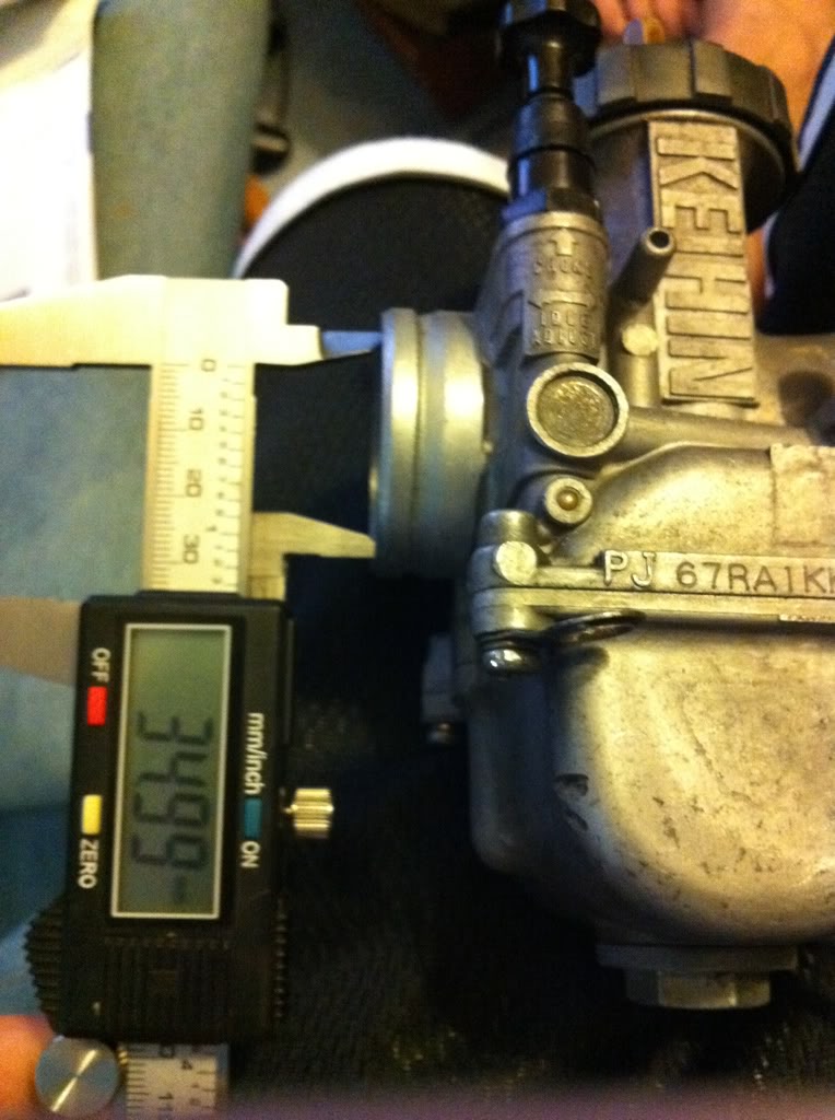

and i know the calipers are not completely inside it but they were both on the ID. if i stick them deep in it i get a reading of like 34.68-34.79 cause its hard to hold them correctly and the slightest movement knocks it back down like 2mm

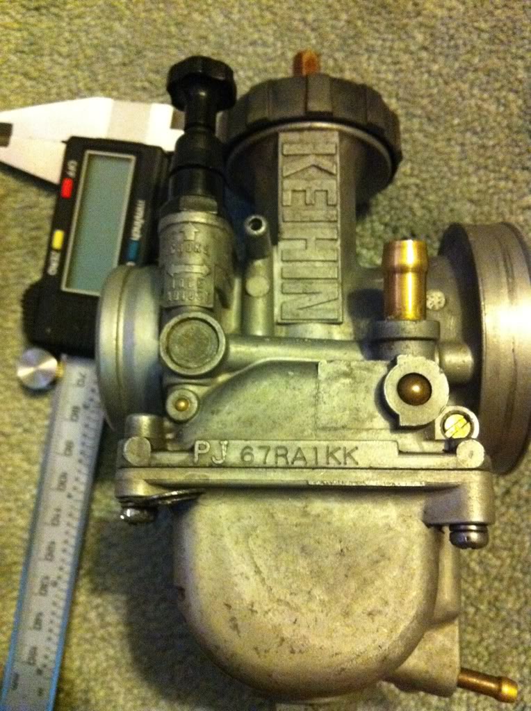

Well the measurement is taken from the outside, and a 34pj is 41mm on the engine side so measure that! and what do ya get?
You are correct! That is where the measurement is taken from! I'm gonna see what i can come up with for ya.... But as AWK said jetting won't be that far off from a 34!
So wait a second, your saying I measured it correctly then? Or that I should have stuck em in deeper? And yes please see if you can uncover anymore info, thanks slick!
The OD is spot on 41mm... But now I'm confused again as to weather I measured it right or not on the ID? Even if the OD says it's a 33mm the inside doenst match up correctly right?
Wait I think I get it... Side "A" (engine side) should measure 41mm & side "B" (air boot connection) should measure 59mm! And both sides matched up perfectly ps-side "A" & "B" is measured by the OD. It has nothing to do with the ID in mm. So long story short and a lot of confusion cleared up. IT IS A 34mm PJ!!!!! Well I'm happy it got cleared up and I very pleased that I only paid $75 for it, dumbass eBay seller should learn how to take measurements before he starts selling items to the public. All in all I'm happy and can't wait to install my new carb :)
Hell ya! You got it! $75 isn't bad either!
If it's 41 mm it is a PJ 34 period! There is a PJ 34, 36, 38 only! check out that link!
Sorry I didnt see that post cause I was do some research too lol. But yes your 110% correct. Even though it's a 34mm PJ the inside diameter is 35mm... But that does not mean it is a 35mm PJ. I guess ya learn something new everyday lol. But in my defense I looked up how to measure my carb and all the results I found said to measure the ID and that's it. SLICKERTHENYOU to the rescue! Haha
