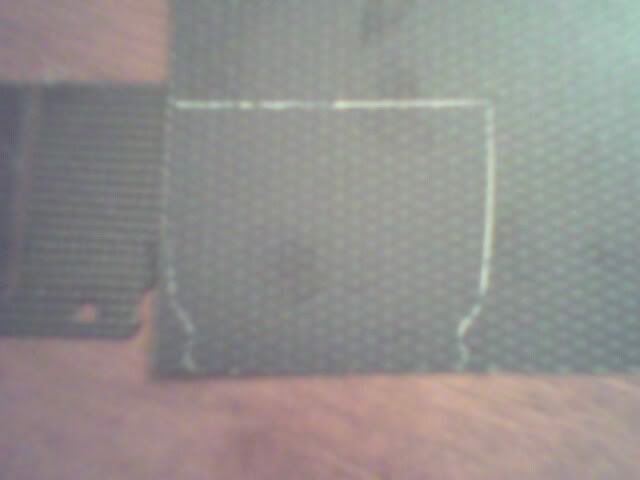

Outline the old onto the new

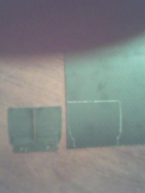

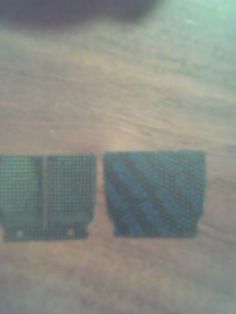

Side by side after smoothing the edges and before the holes

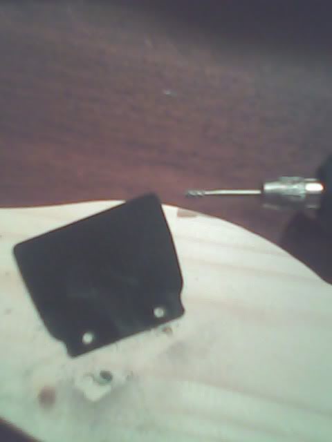

Holes drilled with dremel

not all carbon fiber material is equal ..thicker reeds have less response and require more velocity to open ,also a weak carbon reed can shatter with too much pressure .on your petal you dont have a cutaway gap dow n the center between the openings like the oem deltas ,that will definitly change the response and time duration it opens and closes i would just buy replacements they are only like 45 dollars is it really worth it ? just dont be surprised if the material is possibly less dense or more brittle /weaker (youll never know by looking or touching them) and they eventually shatter and suck up into your motor at high rpm ,trust me that is something that can destroy an engine quick!...just something to think about
My thoughts exactly! Most of the reed manufactures use proprietary materials and processes during production. Simply not worth the chance. I'll give you credit for trying it but would hate to see what happens if they fail. You can see that the two materials are different weaves in one of your pics.
