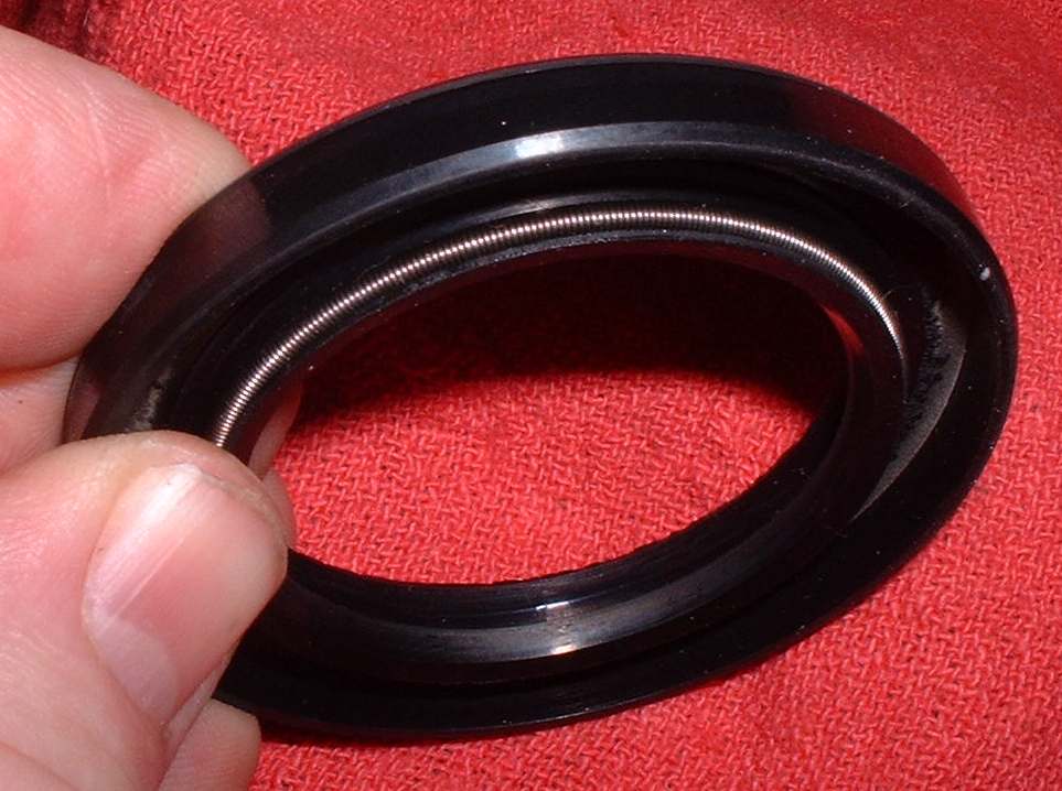

I found a small spring in my engine?!!? What is it?? Also my quad keeps shifting out of 1st and 2nd

Ok i will in a few days and also the big looking washer within all the clutch plates was bent and stuff. I forgot what exactly it was called, but it was like a big washer looking like thing within the clutch plates
Spring could have fallen out of snapped for any reason. Gears in the clutch side would eat the spring up. I would drain oil and give ever thing a insane clean.
