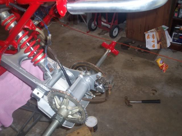

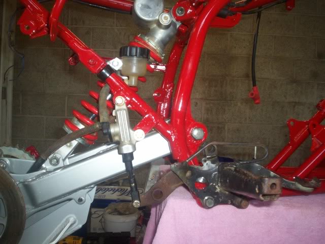

i used warrior rear brake setup but banshee and 03-06 blaster all work, i welded a tab to my frame and used the exsiting heel guard mout to mount my master cylinder i used a p-clamp around the frame tube to mount the resivor and i made a cutom pedal out of the warrior pedal and the blaster pedal and i did a banshee axle swap and just used the banshee carrier and brake hub so i was able to mount the caliper

i bought the complete rear brake setup of a
warrior for 30$ so it cost $30 for parts $8 for fluid and about 2hrs fab and the rear axle carrier came with the carrier i just had to make it work on the blaster swinger the complete rear axle cost 75$ but is not nessesary to do the brake conversion just have to make bracket to mount caliper

does the angle of the master cyl matter much? mine is welded right up that bar instead of on tabs and mine dont work worth sh*t wondering if maybe its the angle of the master cyl. mine just wont lock up and the pedal will only move about half inch. they do get me stopped tho
