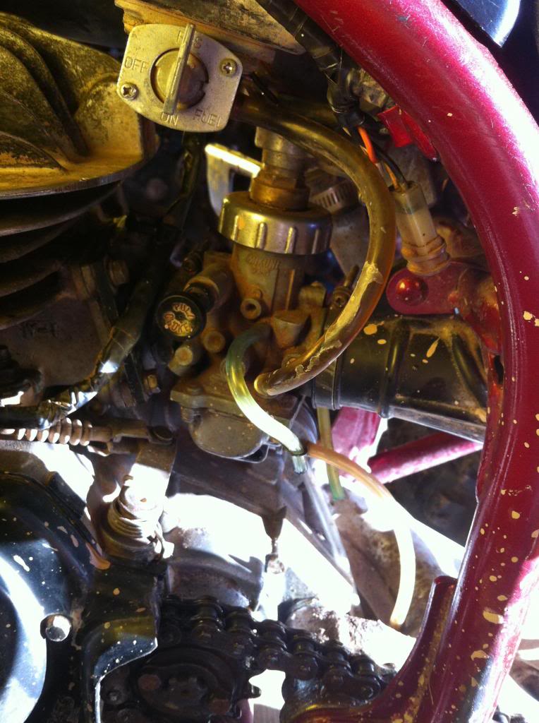

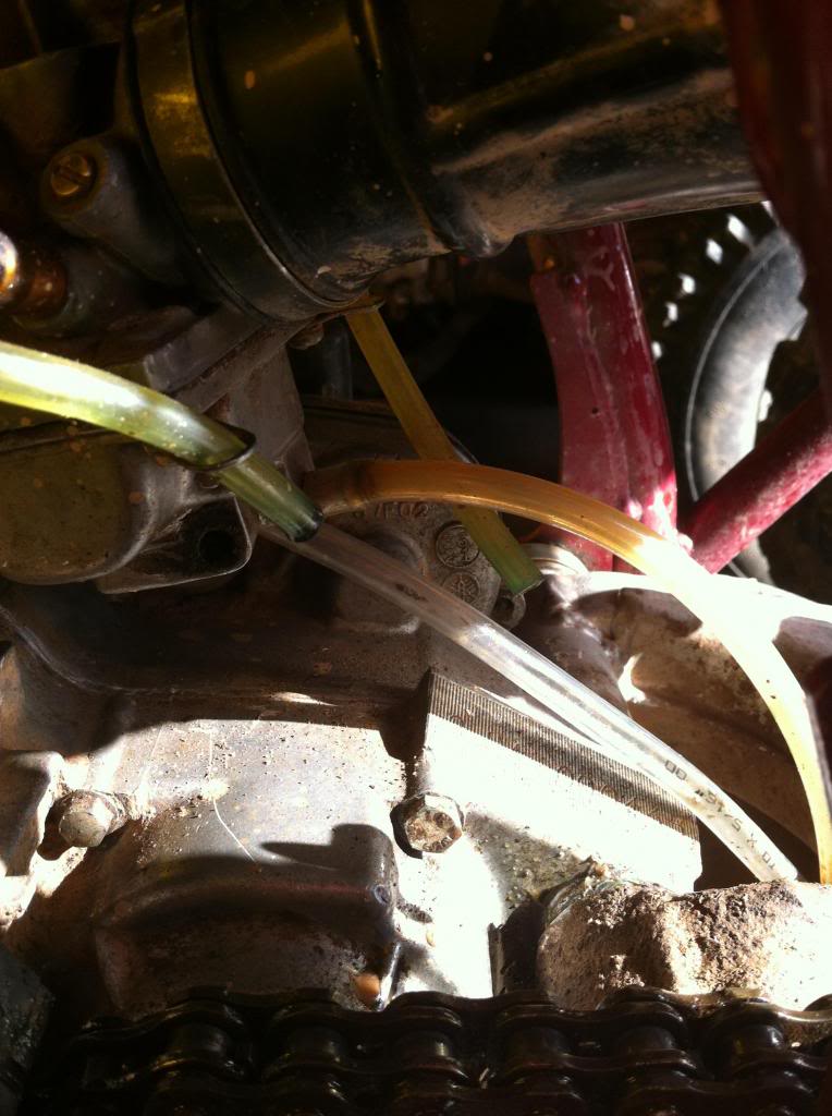

Alright so the oil injection has definitely been removed, the tank is gone, the hoses are disconnected, and there was mixed gas in the tank. I spoke to the previous owner and he said he had it removed, drained the tank, and started using mixed gas.
I am not new to ATVs, however I am new to 2 strokes and I am not quite familiar with this bike. There seem to be 4 hoses that are not connected to anything, I grabbed a couple photos and was wondering if all of these are for the oil injection, or if there are some other issues. There is one on the side of the carb, one on the bottom, and another which I think is coming from the oil pump.
Those are all vent tubes.on the kickstart side some one has put a screw in the oil inj line.its top middle engine cover
So all those vent tubes are supposed to be like that? And is the oil injection line okay like that or should I take those hose off and put a vacuum plug on?
1 & 2: carb vents, belong open to free air as they are
3: carb bowl drain, belongs as it is, only open when the drain screw is turned counter clockwise to drain bowl
4: is the transmission vent, it belongs run across and up the frame to under the hood, so it cannot suck in water.
as it is risks getting water/dirt into the trans/clutch
pink circle: WTH is that, a rock ?
the inlet nipple for the oil injection is located on the kicker side, high and towards the back of carb.
it is brass, unless part of the small black hose is still connected.
it can be blocked off with an 1/8" vacuum cap, or some rtv and a screw into the remaining hose, as close to the carb as possible
found a good pic of what needs blocked off on the carb, thats an 1/8" vacuum cap over the brass nipple..........
url
notice the original trans vent line running up thru the pic, it goes across above the carb, then up that side frame rail past the fuel shutoff to up under the hood
