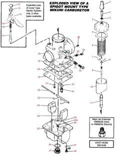

D dczys New Member Sep 5, 2010 21 0 0 May 20, 2012 #1 What is the process to make the needle adjustment on this carb? Thanks!
B blasterdemon7 I'm not winning. Nov 19, 2009 13,642 251 125 55 Delaware May 20, 2012 #2 Take it apart and pull the C clip. Putting the clip on the lower not notches richens it. Upper notches leans it.
