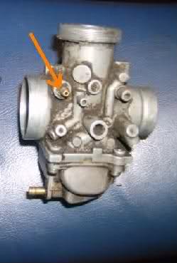

Double check to make sure they did it correctly by viewing this thread, and make sure the carb inlet is capped off http://www.blasterforum.com/do-yourself-20/how-install-oil-injection-block-off-kit-681/index6.html
the pic shows what should be capped off on the carb
The arrow points to it
