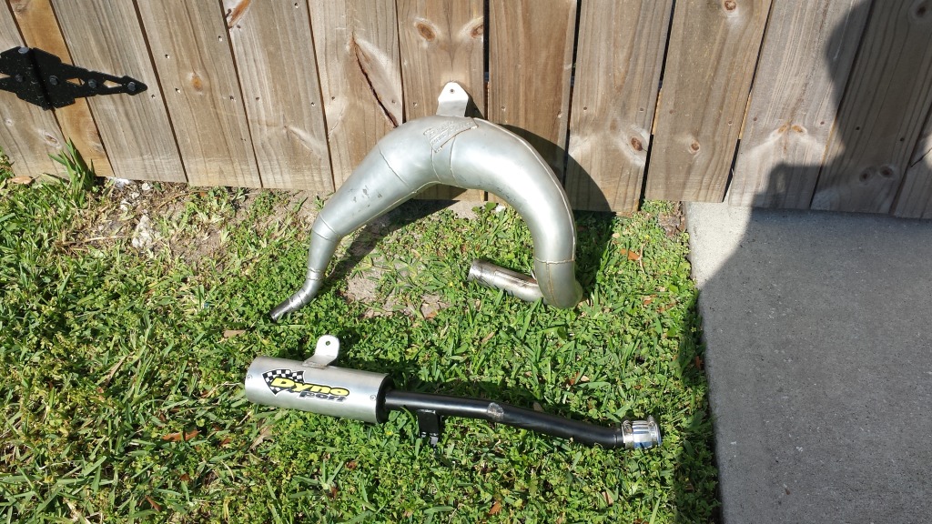

i have a dynoport ceramic coated pipe that is 2 years old and has gotten stuff burnt on it and wont come off with purple power and if it wont come off with purple power its on there good!!
<some of this
and a lil bit of this after^

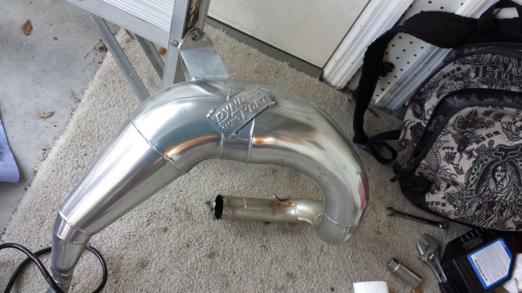

and youll be lookin like this,
just like his but mine looks a bit different,but still coated the same. i have a picture but it says its to big to upload

He's going to have to use an abrasive because of how rough his is, trust me, that crust and burnt on stuff will Not come off with polishing. polishing requires a smooth surface.
I've known people to start out on polishing the ceramic with low pressure bead blasting. I was just confirming that the directions call for the use of abrasives on the ceramic.
