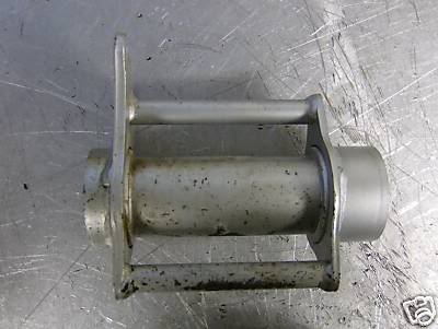

think they are the same maybe diff brake mount

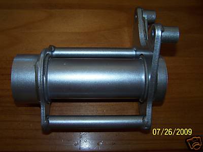

First pic is of an '88-02 carrier, second pic is of an '03 and up carrier. The main difference is the way the rear caliper bolt's up to the carrier
yup just like i said
Its not the rotor it is the disc brake mounting bosses that is different. The brake on the 03+ are not of a floater design where the 88-02 is (as far as I can tell) a floater. I have both types of rear brakes and when I look at the parts the only difference that I see are the mounting tabs on the carrier and the disc brake hub might be different (can't remeber). I think that everything else will swap between the two different styles. I have read that you can use the floating disc brake hub with hydro brakes. I hope that this helps but I know that someone will correct me if I am wrong. Most of what I have learned about this for my conversion came from searching this site for answers. hope this helps and is correct.
