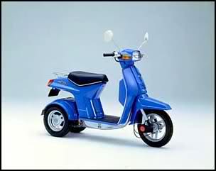

I got this weird moped for free off of my moms friend.. its real odd lookin its like a spree but has two wheels in the back
Supposably is really rare
Anyhow it has oil injection on it but is missing the tank
can i just block off the carb and run premix?
Anybody that knows about one of these or ridden one plz hit me up.. hahaha
far from my blastys bt maybee sum1 here can help me...
Idk. It pivots when u turn... look it up on YouTube they look like theyd handle on the turns but maybee they're
dangerous... my moms friend was gonna throw it on the dumpster and I told her I could sell it to make something off it. And turns out it's one of the rarest mopeds Hondas made...
I'm pro blasters though!!!! I wanna sell this and get more stuff for my blastys lol
You should be able to just block off the oil injection and run pre-mix. I did this on an old '82 Honda Express scooter, and it ran great with no problems. It might be a good idea to re-jet one size richer on the main jet. Let us know how this one works out! I've seen a few of these on the local CL here in Texas. Really interesting.
I would try to find a tank and fix her right, do some research and see if the oil pumps directly into the crankcase (good systems for scoots) remember a potentail scooter buyer is not going to want to mix oil and gas, they will want to gas and go
I agree try and get it back to the way it was stock.
the spree tank from that year looks to be similair if noe the same i got one on ebay coming for $11 so if it doesnt work im not out too bad..This thing is a biotch to find stuff for..I wanna try to sell it eventually sell it so im gonna try to get it running on just gas..
