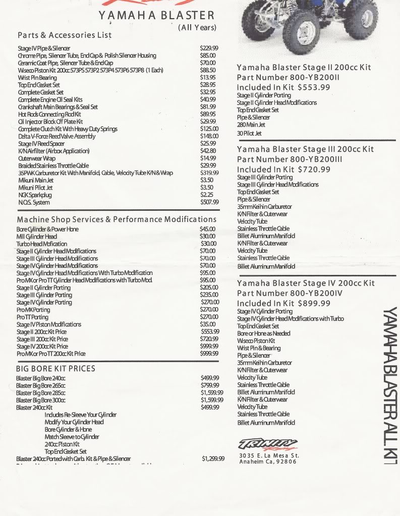

Some old Trinity advertisements from the past... I see a 240, 265, 285, 295, and 300cc kits, but i also remember seeing advertisements and people claiming to have 280, 305, and 310cc kits....
bronco, you're like the resident librarian here posting all these old mag articles,
most of which i remember from the late 90's
