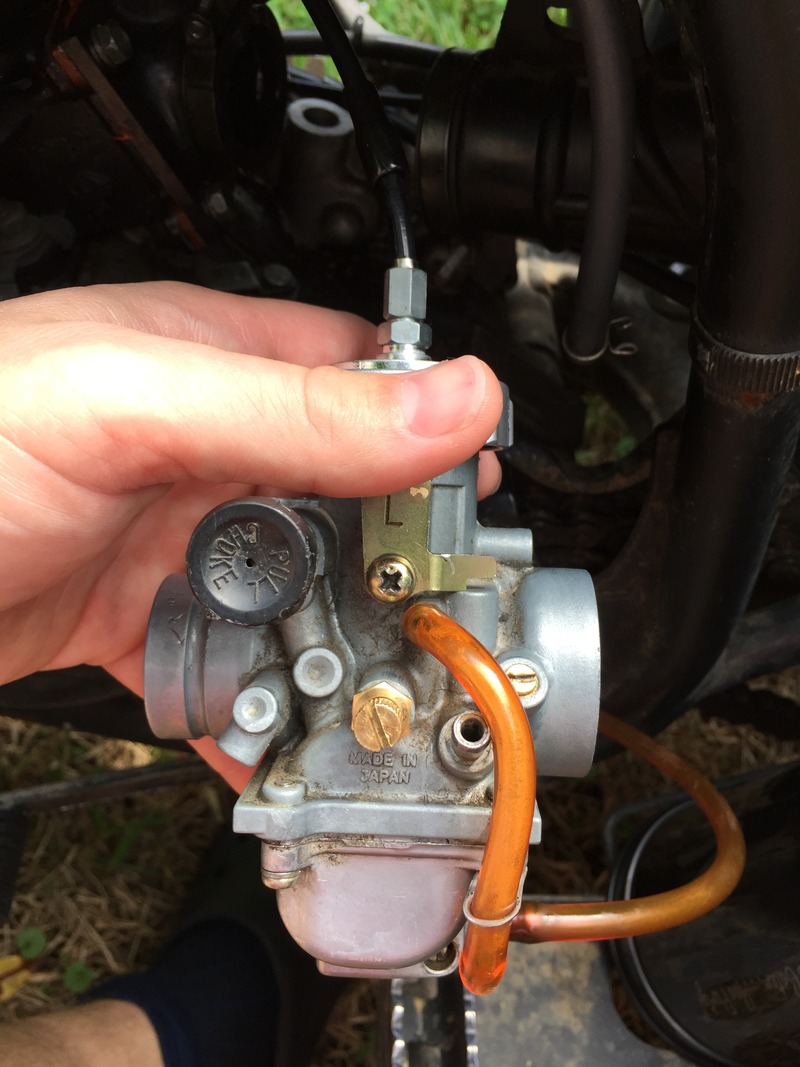

it is at the bottom right of pic just so we are on the same pg...cuz people have taken the wrong ones out before lol:)
the jet needle #4 could be bent,not allowing it to retract all the way down,then gettiing stuck when you lift it.....take pics with carb on quad and apart if you can...

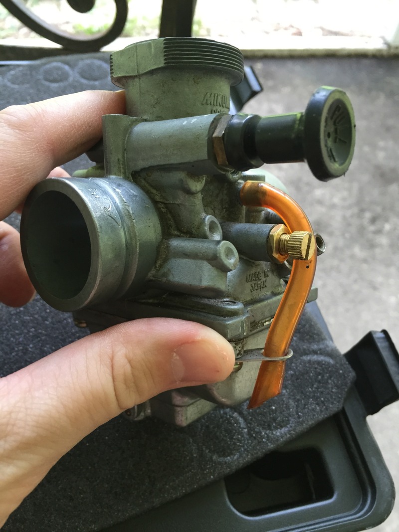

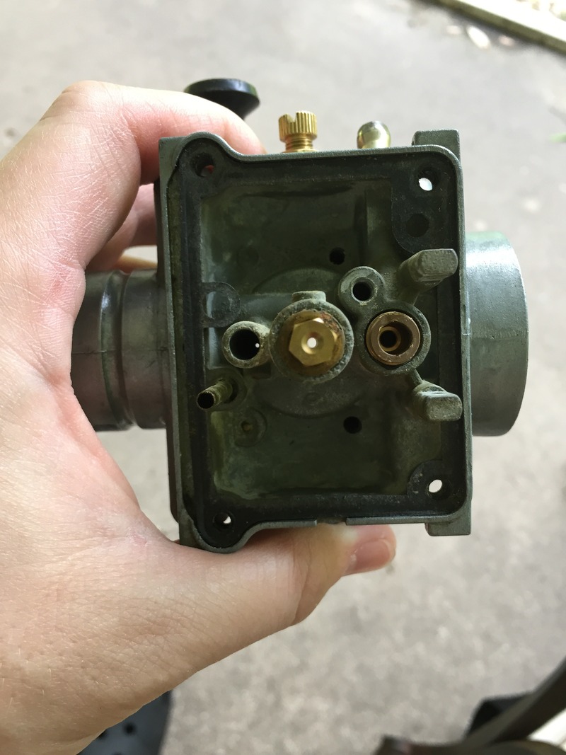

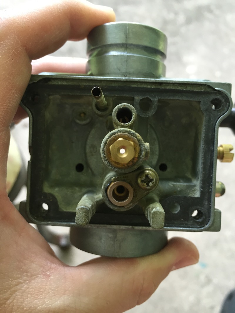

Alright so there are probably going to be a lot of photos, so sorry in advance. BUT... On a positive note when thoroughly going over the carb while I had it apart today, I found that while the pilot jet(removable) was clean and clear, the actual hole it leads to in the carb was completely crudded closed. I had previously thought it was just another hole in the carb that turned so I couldn't straight through but while looking today something clicked and I realized this wasn't the case. So I was able to clean it out and after reassembling was able to get it to idle and not scream away! The only issue was bogging out at full throttle so I'll need to make a few more adjustments but definite progress. Thanks again for all your help everyone, and here's the wall of pictures starting with successful idling!

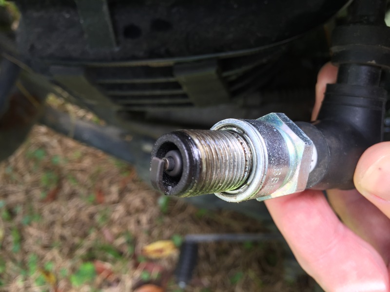

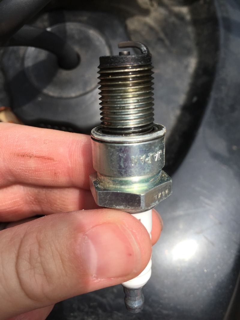

I think my first check for the "bogging down" at top end will be to replace the plug as it seems a little blacker than I'd imagine it should.

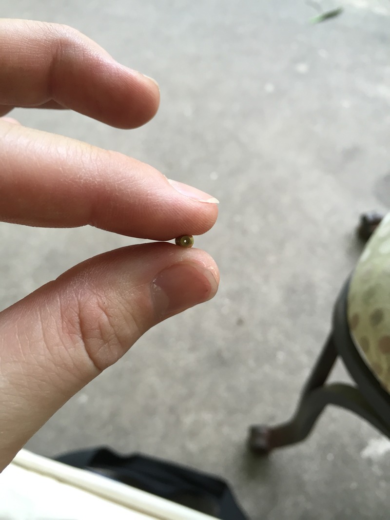

You can see in this one that you can't see through the pilot jet while it's in
And here's the clean jet itself
And here I was able to clean out the pilot hole in the carb and place the jet back in.

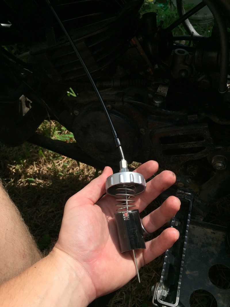

here's my mod, the tors removal. Again much props to this site for instructions,
my only advice would be that the fuel tank and all that doesn't need to be removed to
route the new throttle cable, simply tape it to the old one and and trace it through. At least save a little dis-assembly :)

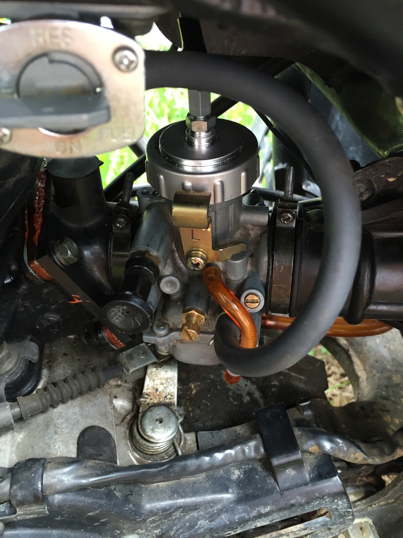

All mounted up and ready to rev(minus the fuel isn't turned on yet)

That pic of the plug looks fine for a plug pulled out after a period of idling.
One cannot really tell anything by looking at a plug unless it has been used to do a plug chop.
