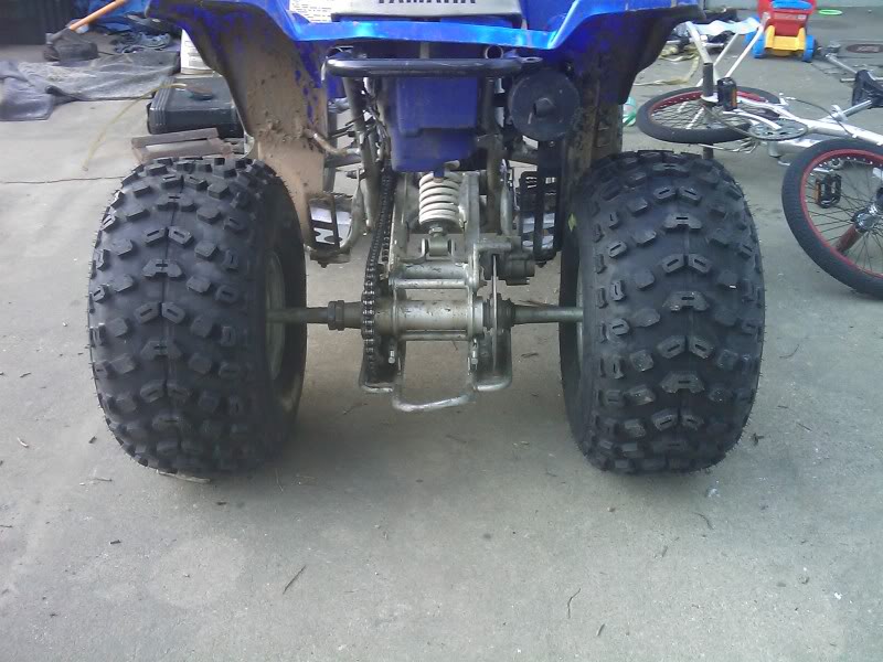

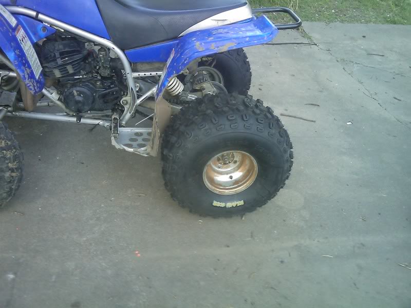

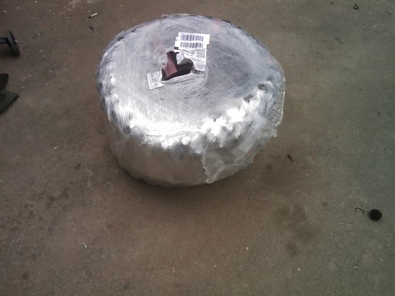

well got home today and found a surprise...
kenda klaws 22-11-8 and a 13 tooth sprocket from rocky mountain atv time to spoon on some tires...
well its my first time spooning on quad tires so it took me a min. i have spooned a many of sport bike tires but they were like putting a golf ball in a 5 gal bucket as where these were like trying to fit a golf ball in a garden hose lol...

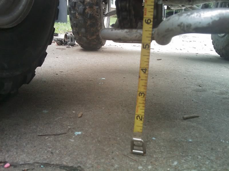

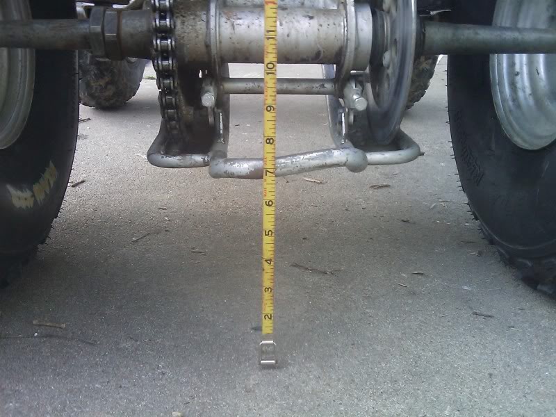

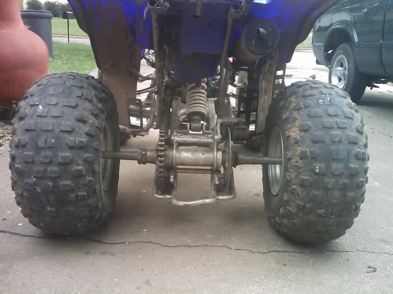

i figured out real fast its best to leave them in the sun to heat up and get a little softer but all in all i can say i will deff be doing all me tires its not all that hard...so here are some befor and after going from stock 21-10-8 to 22-11-8 i gained about 2 inch of clearance...

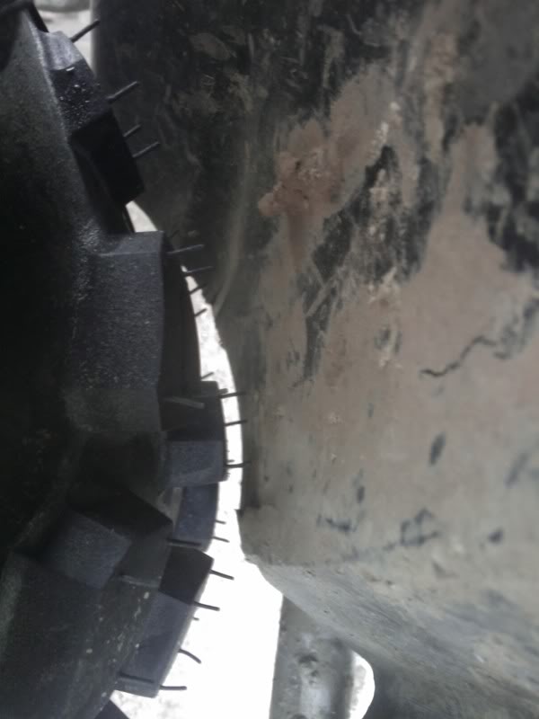

and for sure with out adding spacers or removing the heal guards these are the biggest tires i could fit on there...
so far i was just putting around the back yard and it feels about the same still pulls the front up with ease in 3rd no clutch so im happy with that cant wait to see some mud these things are meaty lol much better than stock.
nice right up dude, i like how ya showed the clearence gain, they're prolly gonna rub the heelgaurds when you jump or corner hard
ya they prob will but they are just plastic so ill deal with it lol...and im guessing that the reason i gained 2 inches is for one i went from a 21 to a 22 and then the tread on these and about an inch plus they look alot better lol meaty
