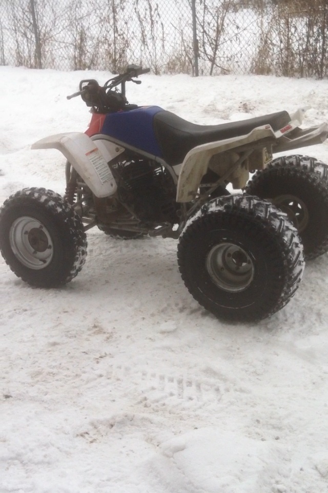

The one in my Sig is a +4mm crank, ported 240 motor. It was built by Ken Occonor racing and it rips. I love when people say "What is that?" Doesn't even look like a blaster anymore. You can transform it into anything you want. A blaster is the cheapest bike to mod.

I know im jumping the gun here because I havent searched on it but did strokin the extra 4mm help much? That is a badass looking bike! If i may ask, how much do you think you have wrapped up in it?

I think I have around 7,000 in my blaster. This has been done over the last 3 years. There is literally nothing else I can do to the bike. It is just about fully modded.
