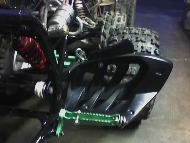

the heelgaurds from raptors and yfz' bolt right to our footpegs, raptor250 % maybe 350 supposedly bolt on at the frame too ? yfz's take a small bracket made from 3/4" steel
they seem to be a cheaper alternative than the hard to find, prone to break again, and expensive stock replacements.
others have threads and pics too, just search

here's mine:

and one more ?? should I put something between the rear fender and heal guard after installation to stop Mud and other stuff from coming of tire onto back of leg
i didn't, you'll get more mud from the front tires than the rear.
