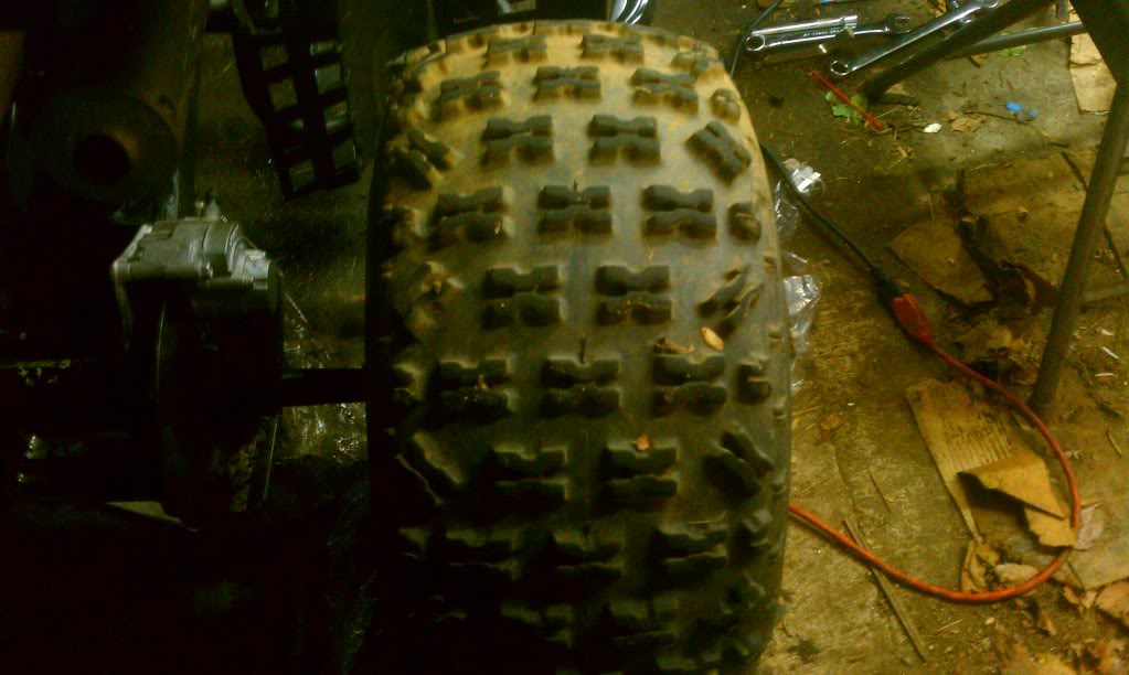

warmeck Member Dec 25, 2012 601 13 54 Connecticut May 30, 2013 #1 the only thing is sometimes one of my nuts get loose and i have to tighten it any ideas on how to keep it on? i dont want to loctite it because i will be swapping tires back and forth
Herpderplol BRRAAAAAAAAAPP Aug 22, 2012 6,290 497 136 27 Dickinson, ND May 30, 2013 #2 Lock washer.....
mud runner Member Jan 19, 2012 3,314 29 90 28 leabnon TN May 30, 2013 #3 lock nut what did you pay for them
warmeck Member Dec 25, 2012 601 13 54 Connecticut May 31, 2013 #4 $75 for both and a lock washer? i have to look into that
DUALSTROKE Giving away free clues Technician Mar 2, 2008 5,263 427 134 masshole May 31, 2013 #5 Nylon lock nuts will work well.But you can only reuse them so many times.Tires look great!!!Nice score.
PRChrist 2 Stroke Life Jan 2, 2013 610 21 76 Puerto Rico May 31, 2013 #6 those tires need a wash but still a great deal that what is important.
