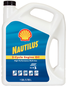

We use regular gas and Maxima Castor Oil. Mix it 32 to 1 and you should be good. No need for anything crazy, it's a blaster after all. Sometimes we even use Shell Nautilus Oil and it works fine. I race in the weekends with my Blaster and no failures so far.
