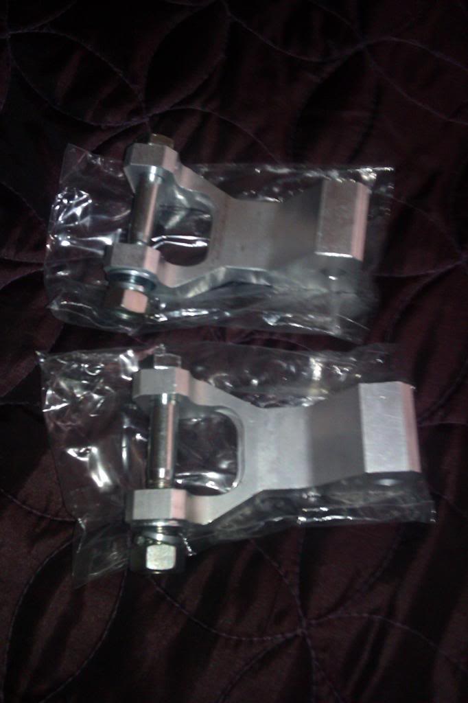

Front Lowering Kit.
Hey, you still got these? And do they fit the stock shocks?
hi mate i haven't actually received this yet. the seller assures me it will be here but if it doesn't turn up by monday im getting a refund for it. if it comes through il be posting picture. and not sure about stock shocks you would need to ask seller. i bought to use with stage 3 elkas but i purchased the diamond J kit instead. thanks
I am afraid that I am not an avid supporter of the lowering blocks, they put a lot of extra strain on the shock mountings as the angle of the shock is changed.
Placing the lower shock mounting farther out on the A arm makes the suspension a lot stiffer.
They may be ok for flat track and Granny riding, but I would never even dream of letting them look at a jump.
