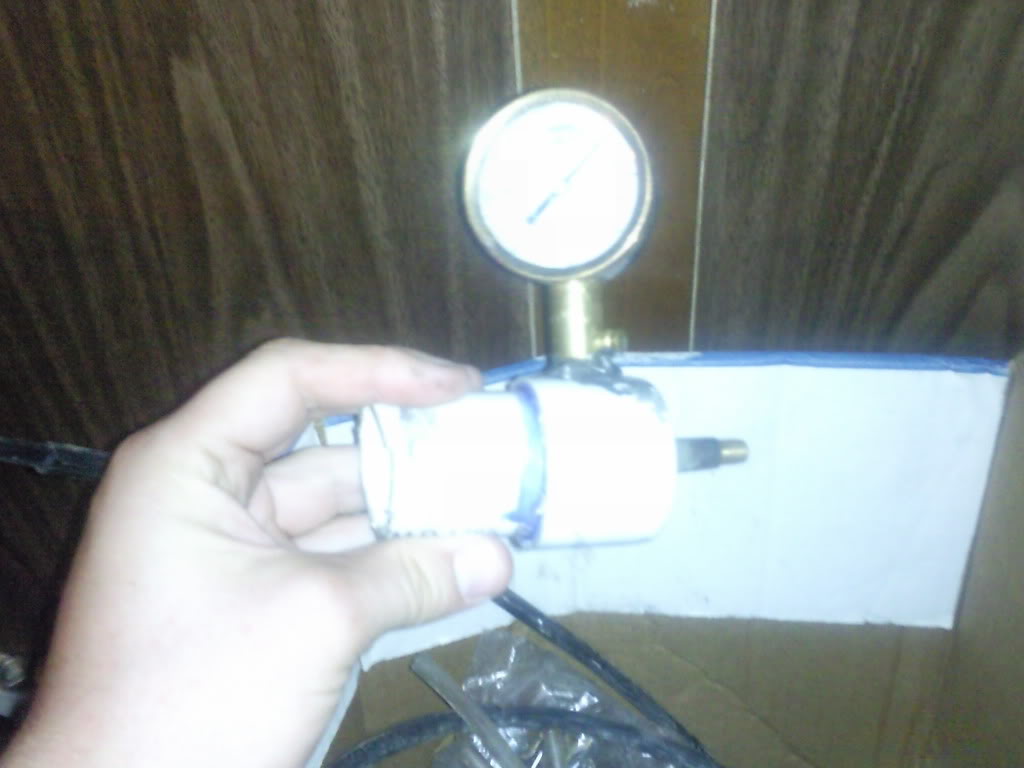

i am sure there is, but to make it simple, find a PVC pipe that fit perfectly into your intake boot. and find a cap for the pipe. glue them together. drill a hole for a tire valve and a psi gauge. seal them. and get an exspansion plug for the exhaust. i have pictures of mine and it worked from for my banshee.

here is my kit
it is simple, just need to make sure the fit is a good fit for the intake boot and you seal it up good.
but with an air compression, to get 6psi was a little to easy, so you have to be carefully not to blow it out. my dad was helping and the psi gauge shot upto around 25psi and it blow the pipe out. thankfully it hit him and not me.
