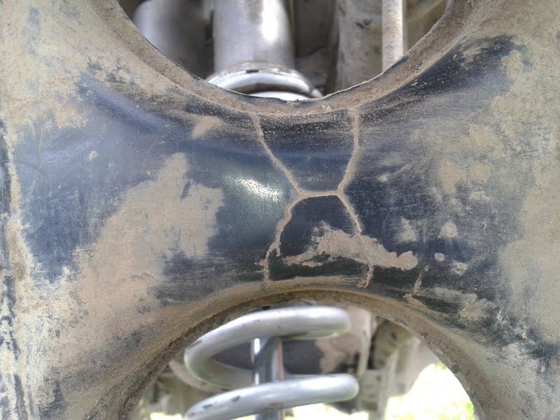

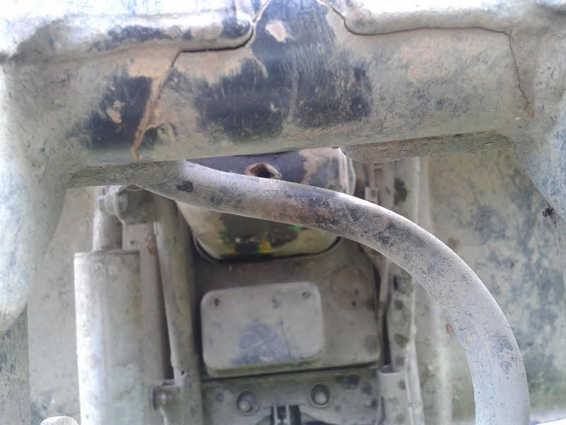

yep, just as i've always preached, here's yet another extended stock swingarm cracked in numerous places.
none of the cracks are anywhere near the extension, nor where any welding heat could have effected the areas that are cracked, more than likely due to the stress from the added leverage extending puts on stamped sheet metal swingarm, that is junk from the get go.
this swingarm came on my black bike, it does not get jumped big or ridden 1/2 as hard as i ride my white blaster, by me, or anyone I allow to ride it.
it appeared to be extended better than any i've ever seen hacked together by anyone on here.
it has multiple cracks on the front X cross brace, and on the stock shock mount cross brace, which is no longer used.....

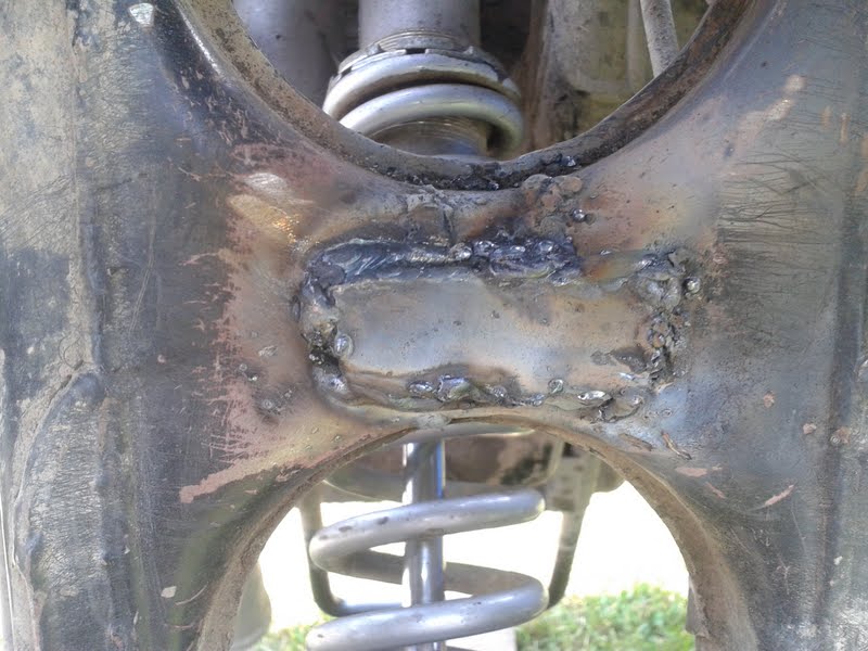

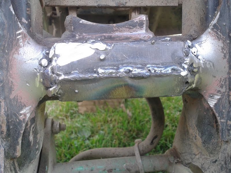

and here's the band-aids on the bullet wounds,
bubble gummed on 3/16" plate with my stick welder, trying to not burn thru the thin sheetmatel of the swinger .........
i didn't care what it looked like or how strong the band-aid was, as this bike MAY get ridden gently until a new swingarm can get ordered,
and this death trap swinger will be going to the scrap yard
i'll state it again for those who haven't seen me speak the truth before...
someone is going to end up seriously hurt or killed on these extended stock stamped steel garbage swingers !!!!
