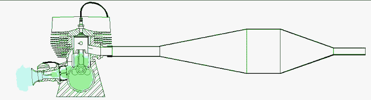

Now a 2-stoke on the other hand, you want MORE back pressure since the compression and exhaust stroke are the same. Meaning, your fuel-charged air actually goes into the exhaust pipe, or, "expansion chamber" (vs. header) and then gets sucked back in on the upstroke into the combustion chamber. This is also known as supercharging. That's why 2-strokes with small displacement have more power compared to a 4-stroke.
So why don't we plug off our pipes on a 2 stroke for maximum backpressure and maximum power? Why do we look for free flowing silencers for more power on 2 strokes? Why does an oil soaked silencer kill the power of a 2 stroke?
It is all a balance, the backpressure thing on a 2 stroke. It is a balance of the pipe volume to the stinger diameter and flow. We want the backpressure to increase just at the end of the exhaust cycle, just before the exhaust port closes. We still want minimum back pressure, in fact a vacuum, at the start of the exhaust cycle. This vacuum is created by the momentum of the moving gasses in the stinger pipe, and the tuning dynamics of the pipe shape.

Pipe dynamics on a 2 stroke are very complicated, and involve both flow and sonic tuning. Flow is affected by heat because it increases volume and velocity and reduces density. Sonic tuning is hugely affected because heat changes the speed of sound, effectively increasing the tuned rpm of any given pipe. This effect can be helpful to us because low rpm and load tend to keep the pipe tuned for a lower rpm, while high rpm and load tend to heat the pipe and its gasses so they deliver power at even greater rpm. Heat wrap and retarded timing both help this effect.
Nice, I like details. I was just trying to keep it simple for this 15 year old kid. But I (and many others on here) appreciate details like sonic tuning, etc. That's what the forum is for, to discuss!
I liked your illustration. Some of us are visual learners. Unfortunately for me I think I over-saturated my memory. But that may explain why I can't seem to remember a damn thing my wife says!
im goad you posted that diagram well i want get it then
