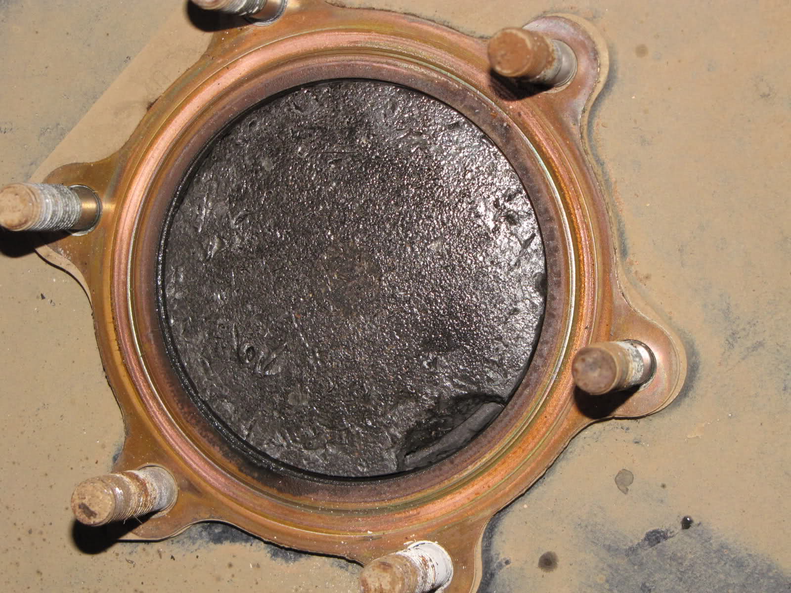

Alright so heres the deal. Yesterday we went riding and I sucked some water up and well the pistons shot and the head is screwed up also. heres a pic of the piston
well a friend said he was goin to get a big bore kit for the blaster, but some guys were saying i need to get a forged piston also. Then 4cfed said to put a +3 stroker crank in it. I was wanting to get some peoples opinions on what to do or what will yield the most power. Thank you all for your input.

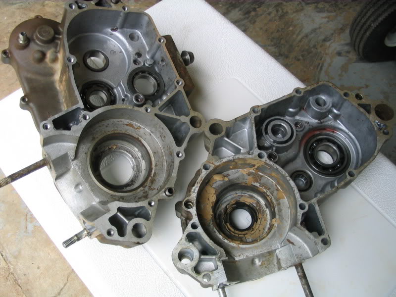

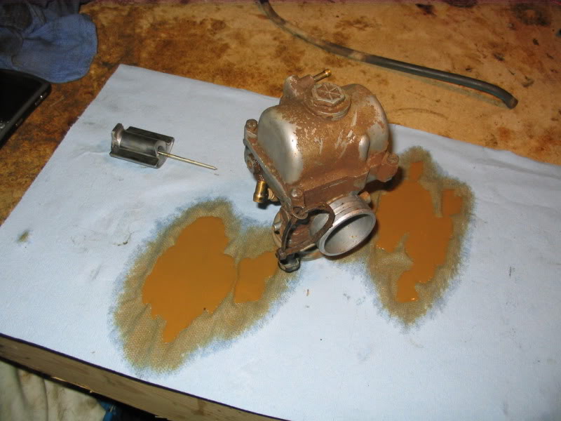

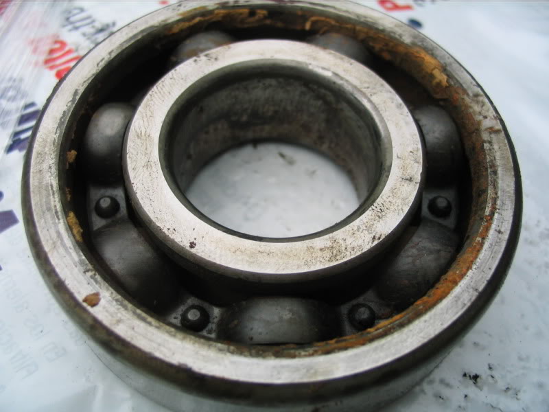

I know your doing the bottom end and the top end ...good choice a few pics of my sunk kdx
sucked mud/water
also came down the pipe into the cases
example of what happens to bearing whith in a day

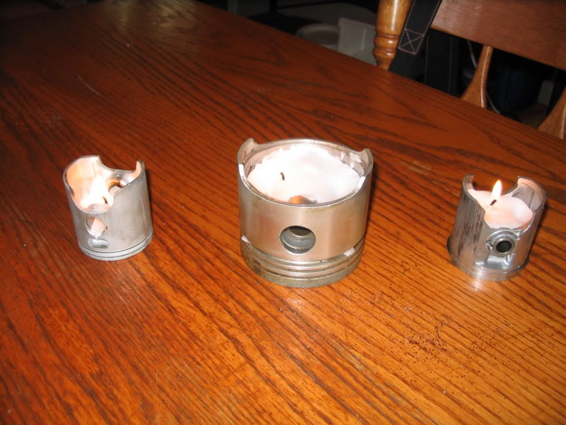

little something I do with the carnage after a rebuild
incase you cant tell I make candles out of the old pistons
sorry to hijack with nonsense crap though
Just out of curiousity what caused all the impressions in the piston?Ive seen many hydrolocked car and truck engines but none came out looking so beat up.
Did the head come apart as well?
all of the nicks are caused by pieces being sucked into the cylinder. In this case it was the edge of the piston that broke
