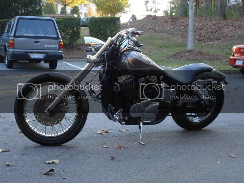

in fact, chrome would be MUCH harder to keep clean than polished aluminum! i have a sh*t-ton of chrome on my street bike and that sh*t's a pain in the ass to keep shiny. even water leaves residue on chrome that you have to hand polish. i've polished a buncha aluminum parts too and those are def easier to keep clean than the chrome. plus if you do a good job (w/ all the right sanding and using the right compounds) the polished will look just like chrome. you can see that my aluminum fork sliders look just like the chrome forks......
