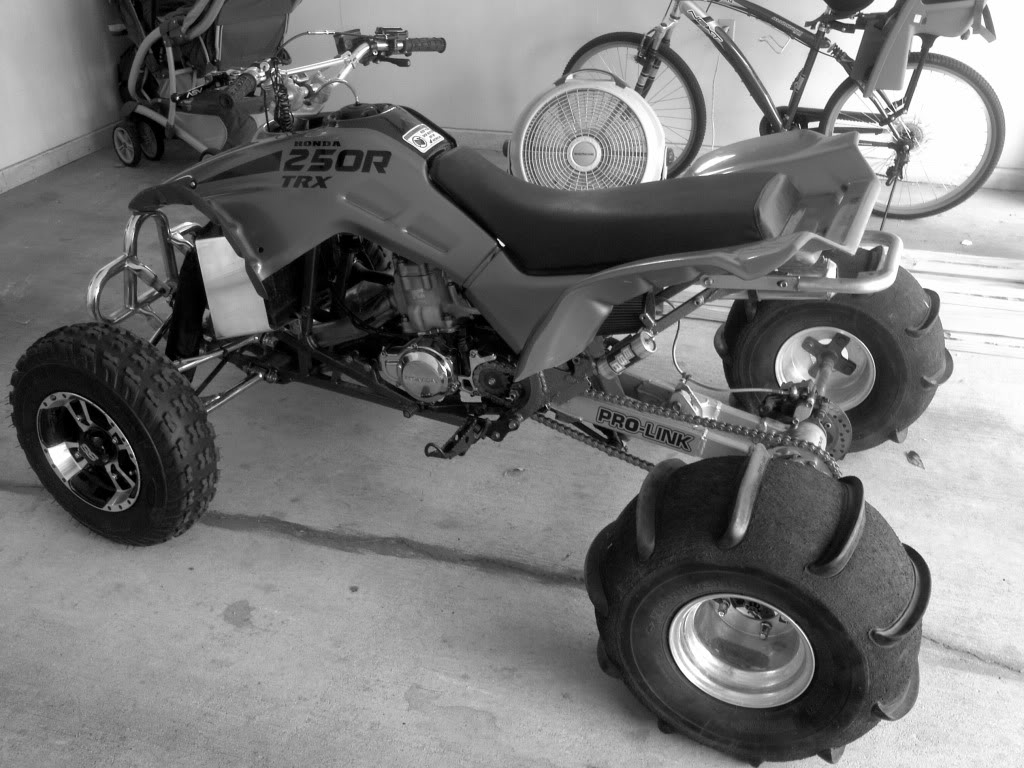

This was my dune bike
But then converted it to this....
Sorry it's not a yamaha!

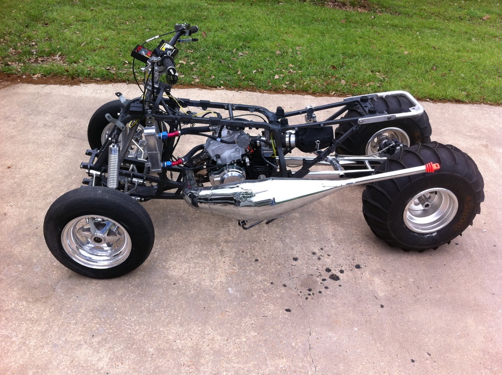

Here's a pic of the bike right now..
FYI thats a pre 2003 blaster.. Run the vin to find out exact year.
Front brakes,nose,fenders,and the front brake lever has the emergency brake cable for the rear mechanical brakes give it away :)
Just informing you is all.
