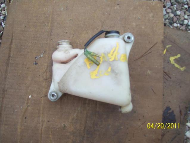

or is oil injection still present?
Is there a small tank under the rear fender. Should look like this and have a black bracket around it
