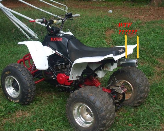

does anyone running these DMC's know if the silencer can easily be cut down and the end cap replaced/moved inward ??
i've got a thing about silencers that stick out way past the plastics
(FMF/DMC ect.)
I'm considering giving this pipe a try, but only if i can cut it to fit better/to my liking
(FMF/DMC ect.)
It for sure can be cut and shortened , But I Would not do it to mine , Even though I do not have a Grab bar , I Have yet to get it close to dirt or pavement
Here is a close up of when I got the parts blasty , the End Cap has Threads in it , so the Body of the Silencer could be cut and Shortened Easily with a Band saw !
Edit : The end Cap 4 Screws Are for looks
